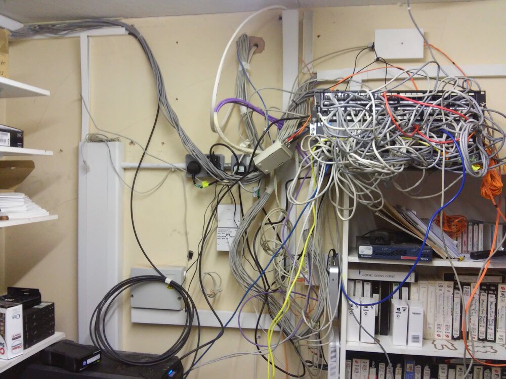

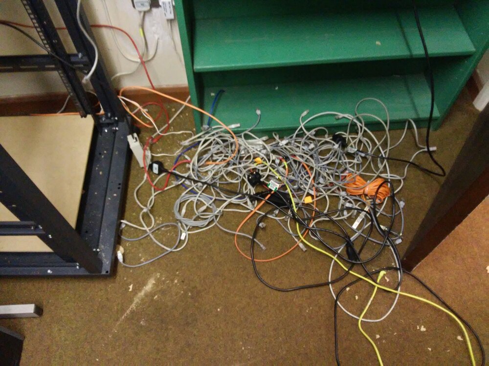

I know you lot like a lovely cabinet re-working, so I thought I'd show you my handiwork from this morning.
Before:
After:
Not quite the usual setup I'm sure you'll agree!
It's a lesson in why you should always use the proper hardware to hang cabinets. Whoever hung this, used bog standard, cheap as chips (Wilko's grade) rawlplugs in plasterboard walls. Hugely surprised it hasn't moved for a dozen years! Not a one off either, the same company that hung that did another cabinet in the same school which fell off the wall last year.

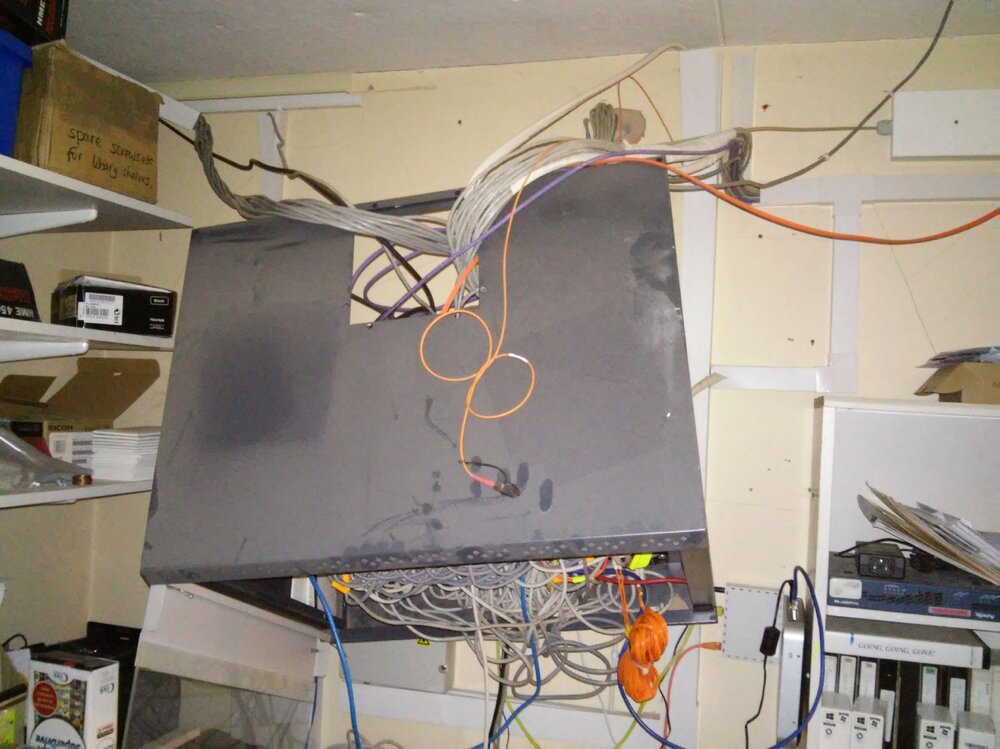

I would have been sat right underneath that, just where the glass door collapsed and nearly impaled a desktop PC on the desk.

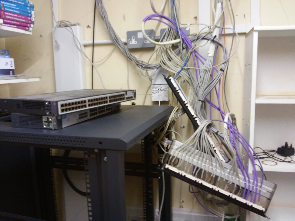

Thanks to years of things being added to it, we had to hacksaw open the back of it to get it off the wall and I decided against trying to re-hang anything!
Damn lucky that noone was hurt, and that none of the fiber cables were broken!
Also worth noting the holes where it was screwed to the wall were not damaged - the plugs just came cleanly out!

Some of those are dated 1985. I jest not ;)

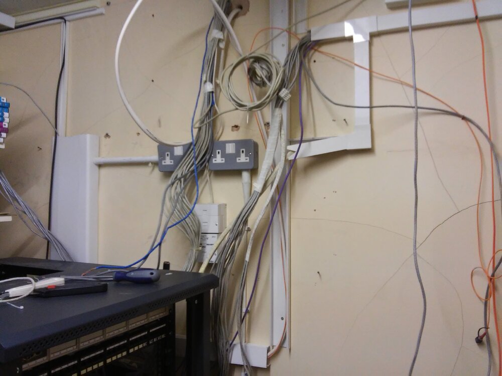

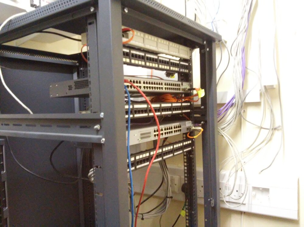

Thankfully, that wiring is just temporary to get them up and running within an hour. Will be chucking those tapes out thankfully to make way for a floorstanding cabinet - and then I will be going OCD on them :D (bearing in mind I'll have to reuse the cables!)
It might as well have been. Just glad there were large enough bunches of Cat5 in there to hold the weight. On it's way down it managed to damage one of the mains sockets underneath it by bending the front down.
To be honest, I've been itching to rewire that thing for ages :D I'll do it properly though, cut & repatch everything!
The after version looks like my server room when I started!
Except for the VHS tapes - they seem to have got rid of all those here
(now waiting for the request for something to play one - due any minute after that comment)

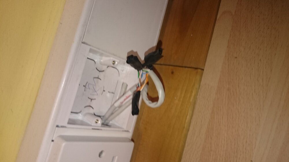

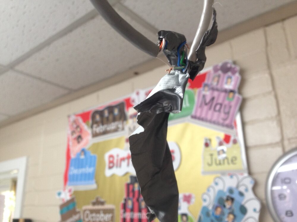

A couple of months ago I did some investigating into why a particular classroom PC was dropping the network connection and generally behaving rather strangely. Whilst following the CAT5 cable above the false ceiling, I moved one of the tiles and this fell out!

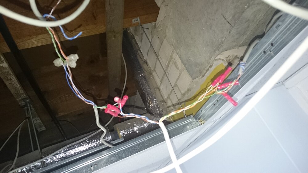

Scratched the surface of why I was only getting 100mb in various places... Found this little lot.
There was a DC hung off one these abominations!

I've come across things like this in the past. It annoys me when they use the same cable for a couple of things too, I put it down to laziness rather than expense, CAT5 is only around £23 a roll now. I'd just run a few fresh runs for what its worth!
Ah, that old trick when you need one more network point, but only have 1 cable available. I think there are probably a few of these left here from a previous 'person' who thought this was a good way to separate admin and curriculum networks...

Probably done as a quick fix, then became out of sight/mind etc. :peep:
The terrifying thing about these is that apparently we paid to have these modifications done, they weren't just bodged by an in house techie or caretaker, these came about in refurbishments and were done by people who should know better!
I suspect it's not a cost issue but more of an effort issue. The thought process is likely "I could run a new cable through the ceiling but that means lots of time up and down a ladder as I go across the school, or I could just bodge it at this point above the destination and call it a day".
That's what people are paid for though! There's definitely no excuse if it has been like that from day one, so easy to run multiple cables along side each other, even with one reel you still have the old double up trick!
