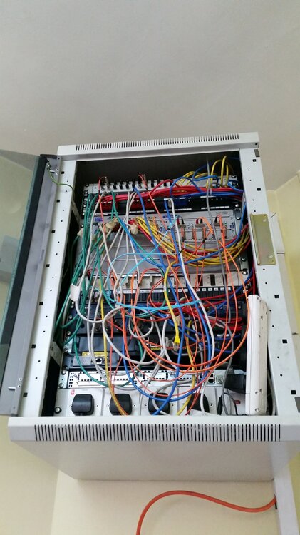

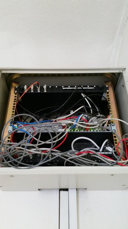

I've took a couple of snaps, these 2 are probably amongst the tidiest of them all but still quite messy.
A lot of them have POE injectors that power our Ruckus wireless system, so that definitely doesn't help either! I just wish I had the time to do it - this summer and next summer are already looking to be extremely busy.

If you're Midlands based I'll come and do it during a holiday. Keeps me out of trouble!
It doesn't look too complicated to be honest, but I'd put money on it that you have 2m patch cables in there!
Yeah first port of call really would be to look at cable lengths in my view, just having the right length of cable makes a big difference.
