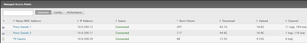

I regularly have 100+ users associated to a single UAP Pro have sites with 60+ APs and have been cloud hosting controllers since the beginning (now have multi tenanted sites running on Azure).
