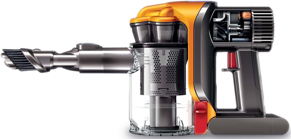

Sylv3r Posted May 9, 2013 Report Posted May 9, 2013 We use one of these. Works well, I just wish the charge lasted longer than it does when using it.
Kingstech Posted May 9, 2013 Report Posted May 9, 2013 We use one of these. Works well, I just wish the charge lasted longer than it does when using it. [ATTACH=CONFIG]18158[/ATTACH] We use one of these as well. I tend to take the hoover and a small paint brush with me when cleaning filters.
