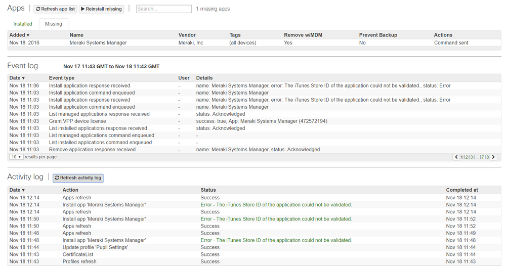

  10. I can not push out apps to this schools iPads for some reason? This is for all iPads in school, and affects all apps too. I have tried removing Meraki profile, reinstalling it. Rebooted the iPads. Removed the app from the app list and recreated it. I have 200 available licences for the app too iPads are Mini Gen1, iOS 9.3.5 Push Certificate is up to date. VPP settings in MDM are correct, in VPP I can sync the licences with Apple VPP. And I can see the device serial numbers next to the app in VPP too. In the Apps list I have it set to VPP device assigned licence, so its not a user based issue. But whenever I push the app to the iPads, I get the error [TABLE=width: 1277] [TR] [TD=bgcolor: #F8F8F8]Nov 18 12:14[/TD] [TD=bgcolor: #F8F8F8]Install app 'Meraki Systems Manager'[/TD] [TD=bgcolor: #F8F8F8]Error - The iTunes Store ID of the application could not be validated. [/TD] [/TR] [/TABLE] This is on the Meraki app itself! I have tested an update of the Meraki app on two other schools from here, and they worked completely fine so please help me figure out what I am overlooking?
