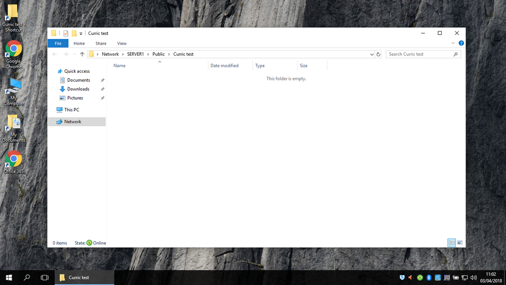

  19. I created the shortcuts wrong! If i create them by using explorer's "New shortcut" feature it hides away the network path.
  20. Hi everyone, I have a shortcut to a folder placed on the start menu or desktop and when it's opened i can see the breadcrumb path the server. Is there a way to prevent this from happening? I've attached a screenshot bellow of the issue. Thanks! Patrick
