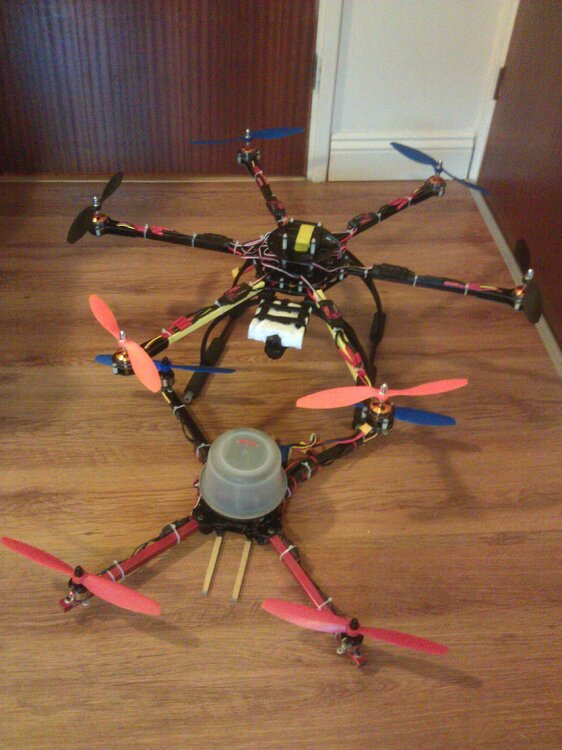

JAB1a Posted January 7, 2013 Author Posted January 7, 2013 Ideal Pete, Hope you had a good xmas and new year, if your building the quad then you are definutly gonna have a good year I say Here is a photo of the finished Hexacopter and my quadcopter that was built from this parts list apart from the frame and 2x extra motors. Maiden flight on the weekend went very well apart from the pilot needs more practice, all six props damaged in the first day of flying, hence why I would say get many...many props.

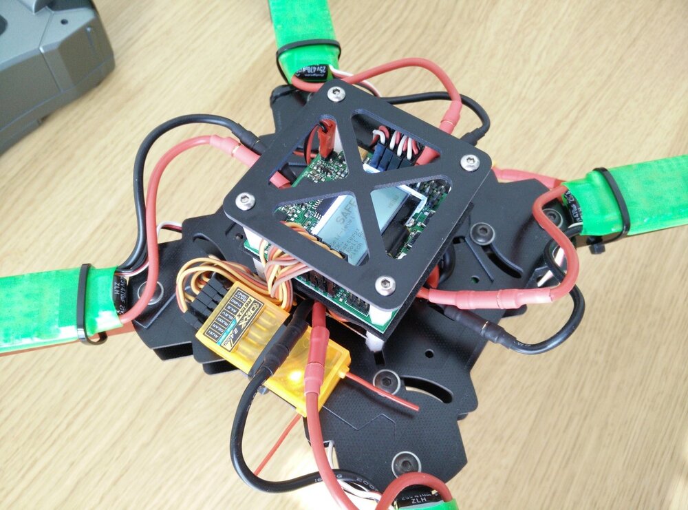

Zimmer Posted February 1, 2013 Posted February 1, 2013 Not had much time to get on here today, I'm two men down and we're having some issues with our macs and to add to the mix our main software distribution point for SCCM has decided to have a heart attack... At least it's Friday! I bought myself a HK MultiWii Lite with the 2.0 firmware, probably not the best decision I've ever made because it is pretty basic. But I've got myself a magnometer and barometer from SparkFun and I'm going to add them to the I2C bus as soon as I figure out all this 3v3 to 5v conversion stuff! As far as FPV goes I'm actually using something a little different, I have a 2.4Ghz CCTV camera/monitor which I've stripped down to bare minimum, but I'm sure there will be too much noise on the video feed but I won't know for sure until I actually do a test flight. If it is pants I'll then look to buy a proper 5Ghz solution, it's worth a try though I guess. Motors and ESC's are starting to really get on nerves, the minute I think I've found the right combination for the right price I then see something else and completely change my mind! I really want some Turnigy G series motors but the price on them is ridiculous! I've found some E-Max 2212's that look nice, apparently they are the same motors that DJI ship with their FlameWheel F450 just rebranded and they get some really good reviews. But yeah, nice video there, those Hubsan's look really nimble don't they

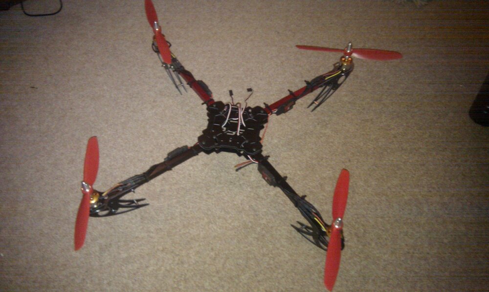

FragglePete Posted February 2, 2013 Posted February 2, 2013 Here's my attempt so far, not the best image but coming along nicely. Bit miffed as I ordered 4 x Prop sets in total, with 2 of the sets being black as my idea was to have the red props on the front and black on the back, but for some reason the black ones are a different pitch (9 x 4.7) so I'll keep it all red for now. Pete
pcstru Posted February 2, 2013 Posted February 2, 2013 Here's my attempt so far, not the best image but coming along nicely. Looking good!
Zimmer Posted February 4, 2013 Posted February 4, 2013 Looking good indeed, are those frames heavy? Are you using Mystery motors there? What do you think of them?
JAB1a Posted February 4, 2013 Author Posted February 4, 2013 @FragglePete There is some great progress right there, damn shame about the props coz it would be good to have different colour props on, my friend ordered 6 pairs of 9x4.7 and one of the packs was 9x4.5, pure lazzyness of the supplier I say because they look so different. I would of thought you were going to take the quad to Florida to have a good fly in the sun to grab some sights @Zimmer cheers for the info, be careful about range issues if you are using the 2.4Ghz vTx, you didn't mention what your radio gear was using? is that 2.4Ghz aswell? if so I would suggest you go straight to 5.8Ghz. Ive not played with the MultiWii boards yet but I have seen some increadable flights with them so I wish you all the luck. I have heard few good things about the DJI motors and lots of bad things about them, from poor construction to complete burn outs......motors and props are a hard choice, trial and error is a great way but I like to find solutions to that people already use, say 2212 1000Kv motors with either 8x5, 9x4.5, 9x4.7, 10x4.5. Depending on the size of your frame and payload then each of these has its advantage, I would stick in the middle with 9x4.5's. So order yourself a load from China along with a stack of props but be willing to wait at least 20days for them to arrive. The Mystery motors and brilliant, for the price they are well made, come with prop adapters and all fixings needed, cost less than a tenner each, get them from a good place and they will come with 2.5mm shrink wrapped bullets. I am using Turnigy motors at the moment but have a load of Mystery motors on order. The X525 frame is brilliant! so tough and super stable. I have modified mine by adding an undercarrage as real estate is at a premium for camera and batteries, I have replaced all the arms with thicker ali which has added a total of 80g to the flight weight but the advantage is no twisting or movement at all. Get rid of the landing feet as they weigh alot, break easy and get stuck in the ground on hard landings which will cause you to flip on takeoff. This is one of the rare frames (V3) that comes with a third plate on top of the center plate that keeps the whole frame rock solid and completly flat at all times. Without camera my frame comes to a flying wieght of about 998g and soon shoots up to 1.2Kg after all FPV gear is added. Another frame would be a flamewheel or a similar clone but I don't like these too much as there is alot of plastic on them.

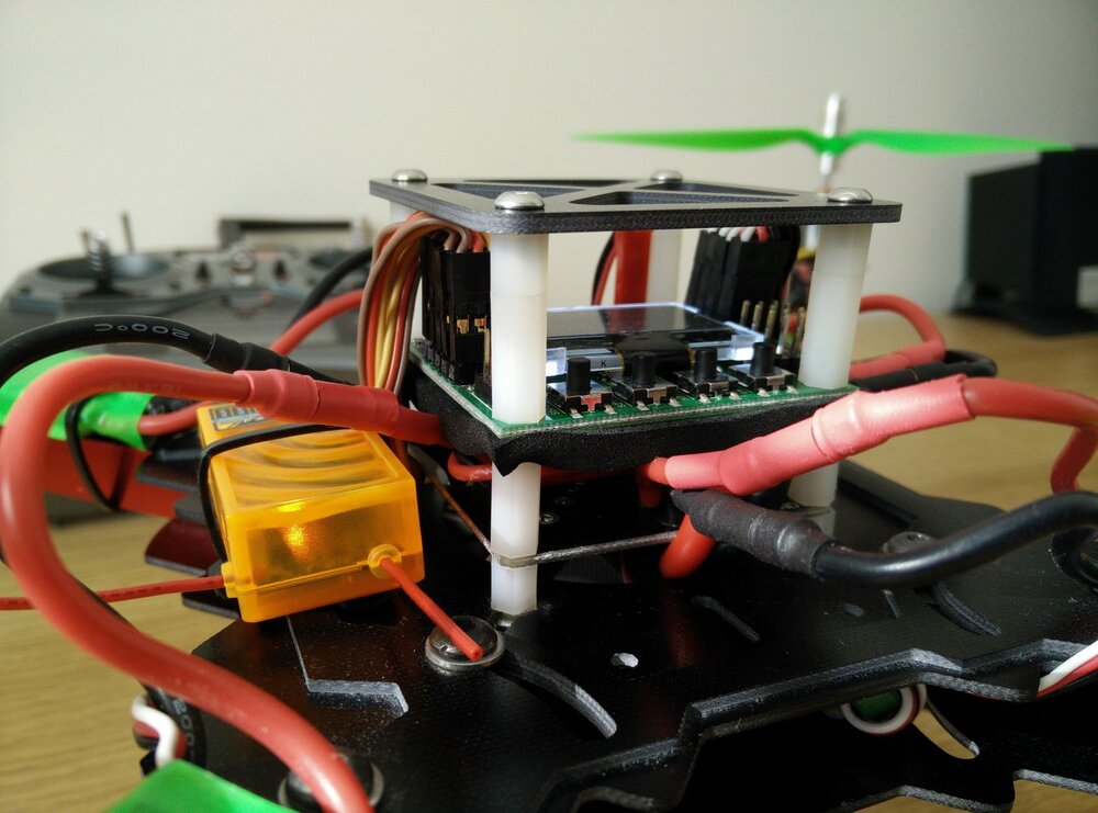

JAB1a Posted February 4, 2013 Author Posted February 4, 2013 It is strange that people (me included) spend hundreds of pounds and 10's of hours to build these multicopters and then rely on a £5 motor and a £2 prop to keep it all in the air. P.S I would not recommend using a CD or DVD case to protect your flight controller, on my first design I used it and it gives little to no protection in a crash as it splits and shatters which might go striaght into the very thing you are trying to protect. Tupperware, its the future...I've seen it, its water proof and large branch and heavy fall resistant.
