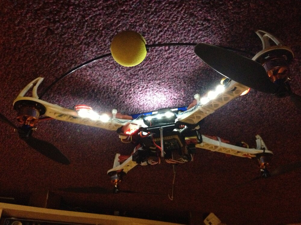

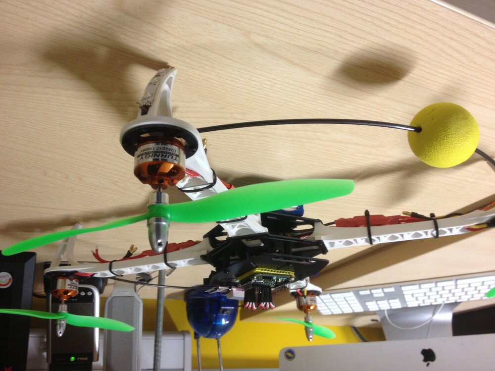

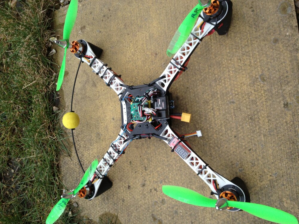

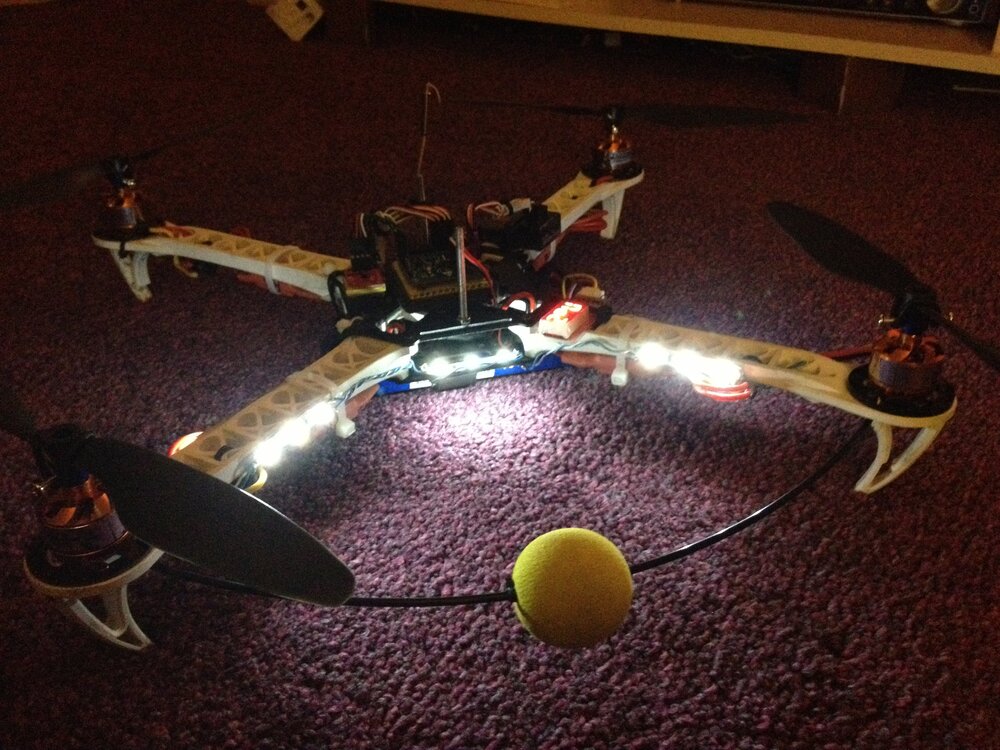

Sorry it's took me ages to post back @JAB1a, since originally posting on here a couple of months back I've had LOTS of fun with my quadcopter... I've probably been through 20+ props, many crashes, a few arms and many modifications to the setup. However I am now flying it really well, found a nice constant with the MultiWii code with very high PID's for a super tight locked in feeling, flying in Acro mode only I'm finally pulling flips at 40 meters altitude easily with lots of head room for stalling With a 4500mah Zippy I get about 9 minutes of mixed mode flight which I'm very happy with, next on the agenda is FPV kit from FatShark and a TBS Disco frame I've also got lots of build and crash pictures if anyone wants to see them

Finally got mine in the air over the weekend... I've quickly realized that it's worth stocking lots of spare props and prop adapters when your first starting out! Ended up buying Turnigy AeroDrive 2822's @ 1100kv, decided to play it safe with the ESC's and got the Turnigy Plush 30A's from HK (SimonK's firmware is going on them this week). 8x4.5 props seem to be working nicely with very little heat from the ESC's when left at full throttle for a while. I'm running the MultiWii 2.1 code on my FC and my next challenge is to figure out all the PID tweaking for stable mode, plus hook up the I2C magnometer and barometer I have ordered from SparkFun.
