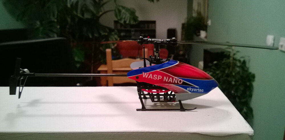

Slightly off topic (only by three rotors), a box with one of these :
Found it's way onto my doormat. I always explain to Mrs pcstru that I'm baffled how they do that. I've only put in a few short flights but it seems a very nimble yet quite stable heli, fully 3d capable (collective pitch) but also comes with a fixed picth mode which is easier to get the hang of.

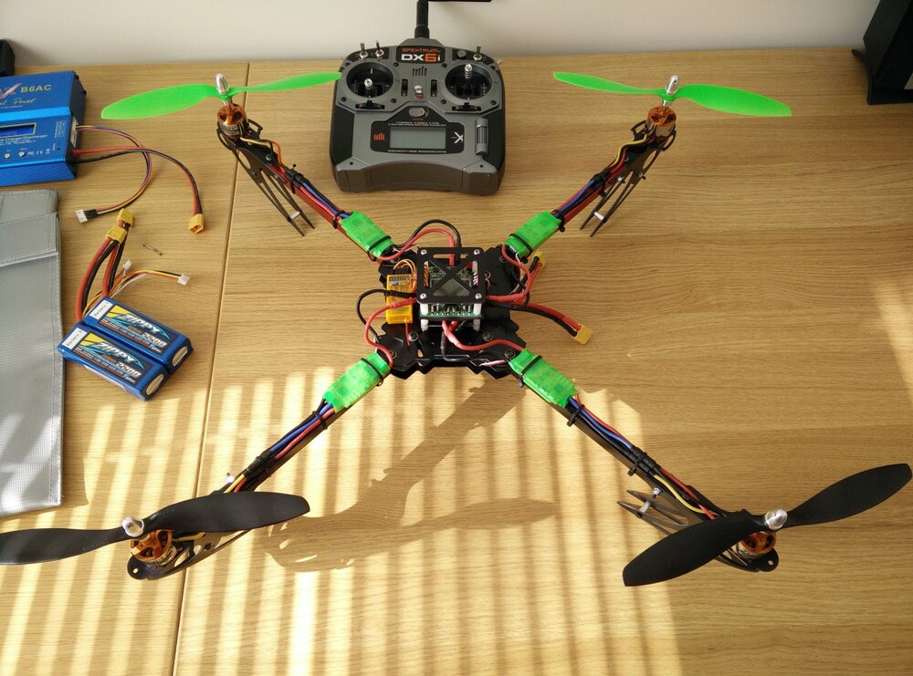

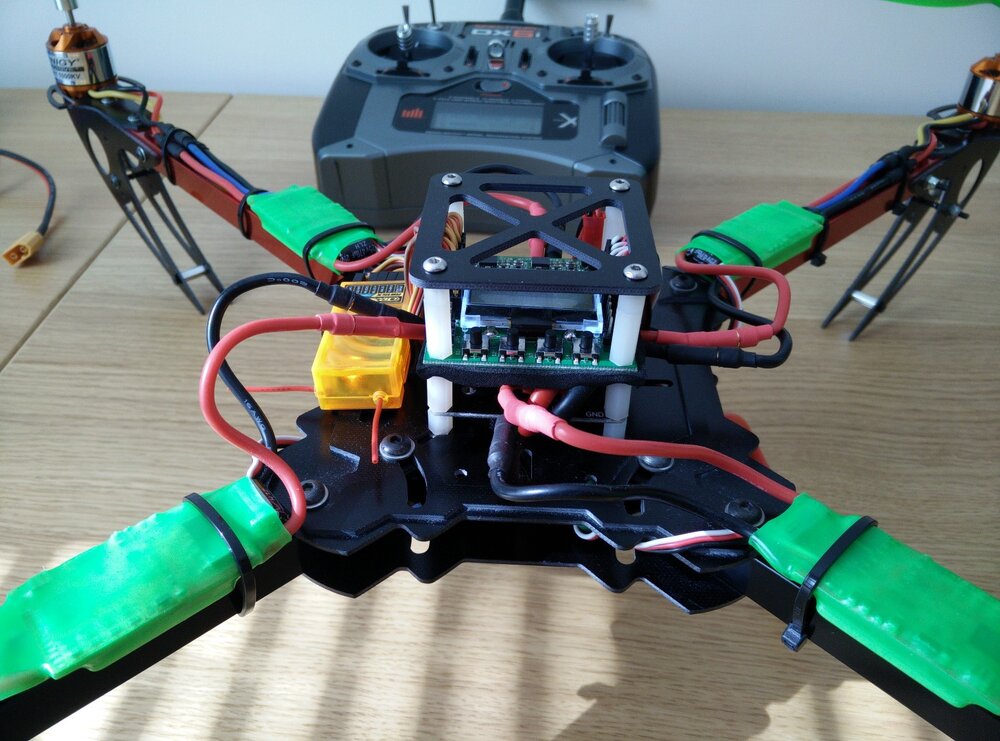

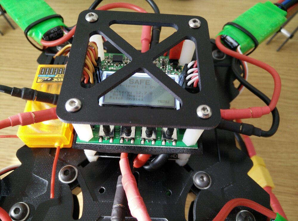

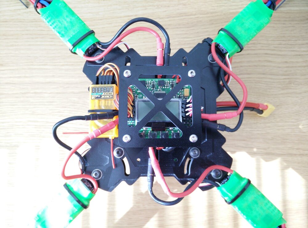

Time for an update! Thought it best to post in here as it was this thread that spurred me on to do this!
Having started building my quad over a year ago, it's finally finished and in the air. The small matter of having our first child and a tonne of DIY meant that I understandably didn't really prioritise building my quad.
Although I ended up picking and choosing my own parts, I bought the X525 frame @JAB1a recommended in the first post and made the rest up from there. Pretty much everything was bought from Hobbyking and eBay and as cheap as possible. No idea what everything cost in the end!
My parts list roughly ended up being:
X525 Frame
KK2.0 Flight controller - Firmware upgraded to 1.6 with battery voltage monitoring added
Hobbyking 30Amp ESCs - Flashed with SimonK firmware and re-heatshrunk

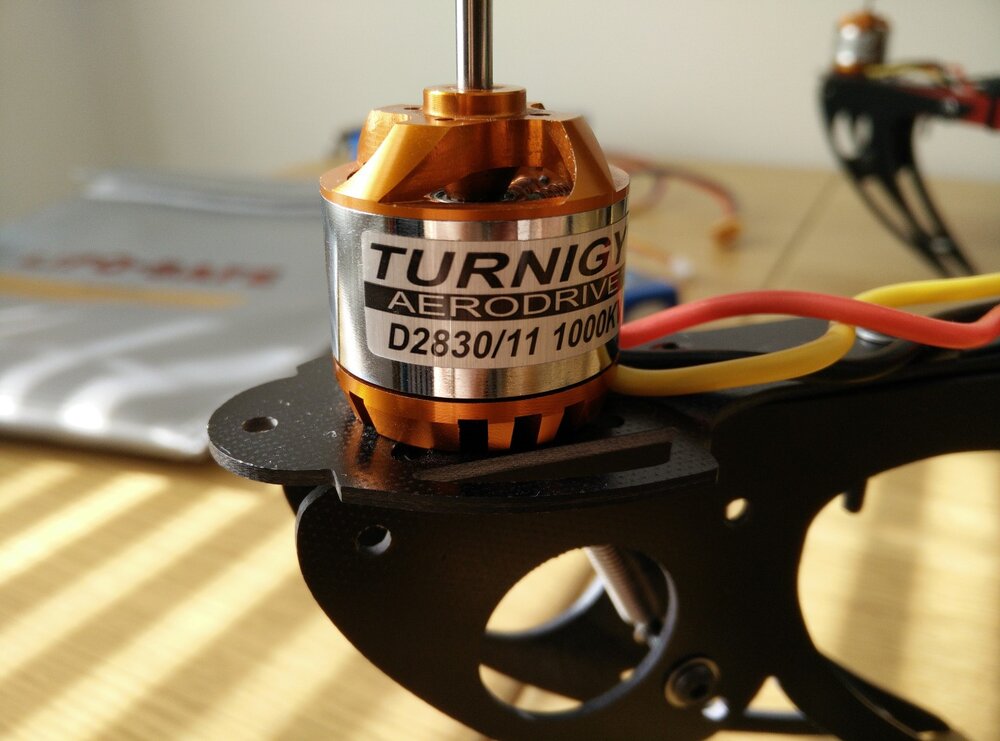

Turnigy D2830/11 Motors (prop adapter which came with these were rubbish, so bought new ones)
Orange R615X RX (I did start off with a Spektrum AR6115e, but it refused to bind)
Gemfan 9047 props (and spares!)
Zippy 2200mAh 3S 25c batteries
DX6i Transmitter (Planning on getting a Glasair Sportsman with my dad so went with Spektrum so we can buddy box)
Lots of cable ties!
That lot above ended up with a quad weighing in at just a fraction under 1kg which I didn't think was bad. I have only flown in the garden a few feet above the ground, so plan to use the school grounds to fully test it out. Initial flights went well.
I've already started thinking about what to change or modify, and I think the first to go will be the motor mounts. I don't think they're going to survive a crash, so will probably mount the motors directly to the frame. May also change the landing skids. The receiver supports CPPM as does the KK2.0 so will make use of this to get rid of the unnecessary amount of of servo leads. The props could do with balancing better too. I quite like the look of the F450 frames that seem to be popular, so if I have a big off, may try one of them. Not too fussed about adding a camera or FPV yet, going to try master los flying first.
I can tell you it was pretty satisfying seeing it in the air for the first time!
Big thanks for @JAB1a for starting the thread and for the ideas along with everyone else who have contributed to this thread.
A few pics of the completed quad:
2014-09-28 11.39.23.jpg 2014-09-28 11.39.58.jpg 2014-09-28 11.40.07.jpg 2014-09-28 11.41.31.jpg 2014-09-28 11.41.54.jpg 2014-09-28 11.41.38.jpg 2014-09-28 11.40.48.jpg 2014-09-28 11.41.08.jpg

That is excellent news and a great write up @Ant the beast is looking good and well put together. I enjoyed reading your update and well done on the new baby and DIY completion.
As you mentioned I would get rid of those motor mount ASAP and bolt the motors to the arms direct using 2 M3 bolts (don't use the horrible Ali X shaped mounts as they bend too easy).
Also I see you are using the 9x4.7 props, I found these too flexible when flying in any kind of wind, the quad would wallow around and get effected by any gusts, swapping to 9x5 props I found the quad felt locked in and it did not care about the wind, plus they are a lot more ridged so more efficient.
Next would be to upgrade those arms, I found under high torque the arms can twist and give adverse effects to your flight, also in a crash the standard tin foil arms do not fair well. I used this Ali to replace the arms
1/2 in x 1/2 in x 16 swg - Aluminium Square Tube : Ali Warehouse
Swapping the arms out for this Ali added on 80g of weight but the improved handling and feel was worth every gram, also in the last 3 years I have not had to replace one arm made of this stuff which is a testament in itself to the strength of the stuff.
Another mod is rotate or flip the top two frame plates so that the arms no longer fold up, I found if one of the arms are only a few mm out then it causes weird handling of your quad, swapping the plates stopped this from ever happening again.
If you ever get a chance to take a video of you flying it would be excellent to see it. Good luck with your multirotor adventure and keep us posted ;)
Thanks for the tips and advice @JAB1a! Will take them all on board. :)
I'd read about the different prop sizes too, so I'll get some more to compare. I did think the current arms were a bit like tin foil, so knowing where to get some stronger stuff is very useful. Will probably get some now ready for replacing. :)
