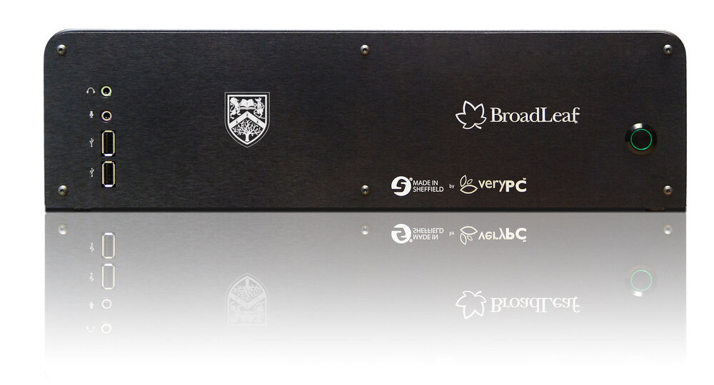

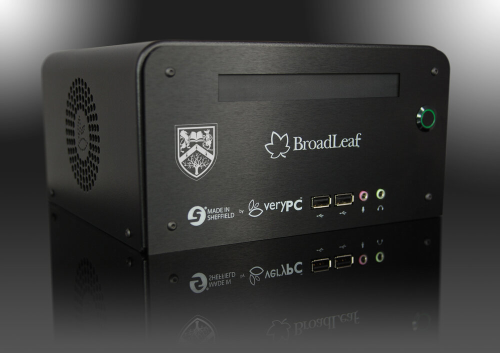

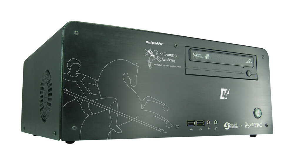

@VeryPC will custom build the pcs to your exact spec so if you dont want dvd drives or whatever, they leave them out. SSDs won't be an issue at all.
They can also laser brand the front of the machine with your logo too. Looks really cool! Let me know if you need more info and pricing

Do you have any sample images of the laser branded desktops?
