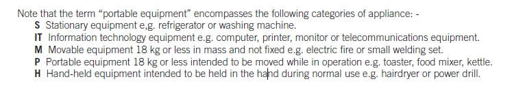

The law requires that you can prove that the device is safe to use in the workplace. (PUWER) If you don't test (or inspect) how can you prove this?
Health + Safety Briefing 34c defines the following ...
[ATTACH=CONFIG]8808[/ATTACH]
Pity that list wasn't in a different order as the acronym formed could have described David Cameron quite accurately.
