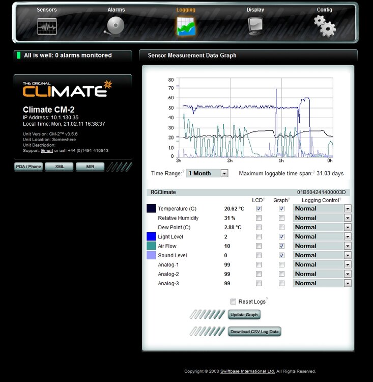

Just bought a CM-2 Climate for us too. Damned good.
Going to fit the anti-intrusion to it, and we have an Axis Camera too that looks like it'll work with it.
CM-2 will be set for buzzer and mail, also will be fitting the damp kit to it as the Airedales in there are not something I'd like to leak under the floor.
