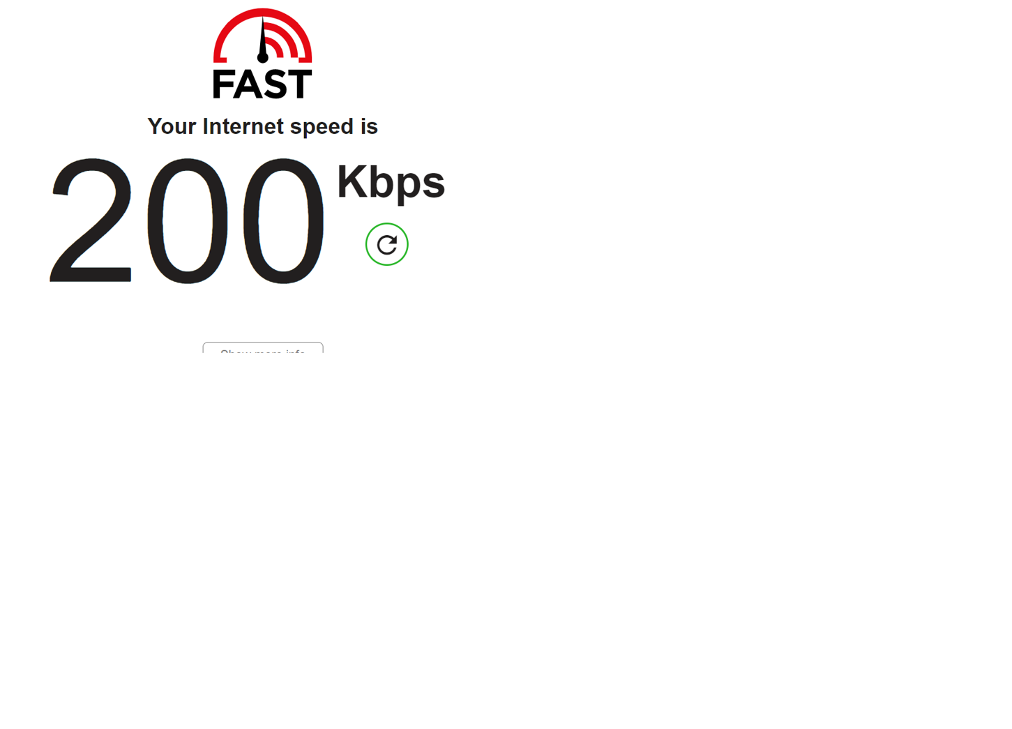

KK20 Posted September 19, 2023 Posted September 19, 2023 I can only dream of FTTP, FTTC would be nice too. As it is we have Wireless point to point. Oh look, its raining outside, so that tree 2 miles away will be playing havoc with SNR
