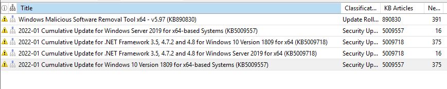

Looks KB5009557 (2019) and KB5009555 (2022) are causing something to fail on domain controllers, which then keep rebooting every few minutes.
I have my server updates auto installed from the 24th of each month.

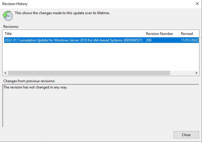

How do we know if this update has been fixed? Might it get pulled and replaced or something.
Always been curious, if I block this update, does that cause any issues for future updates? What I mean is, surely this update is included in the next update anyway, so the problem will come back then.
