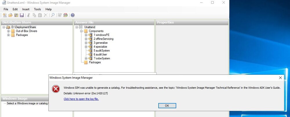

I am currently looking into upgrading windows 10 for the first time since we finished upgrading all PC's to Windows 10 edu 1809 last year. I read the posts above which has been useful to see how others are managing upgrades, and my thoughts were to setup a new WDS/MDT server for 20H2 going forwards but rather than re-imaging I am looking for a way to upgrade our current PC's (certainly the ones with specific software and hardware in offices etc, could re-image IT suites easily). I have selected Windows 10, version 1903 and later on WSUS however it appears the updates will only apply to 1903 PC's and later.
Has anyone else been able to upgrade 1809 PC's to 20H2 via WSUS or a similar method?
Thanks
[ATTACH=CONFIG]61445[/ATTACH]
Im also in this same situation - anyone know?
I've been looking into caffrey's suggestion of using the upgrade task sequence on MDT. It seems like the perfect option for managing and rolling out upgrades, but I've been really limited on time and haven't managed to get it working yet.
