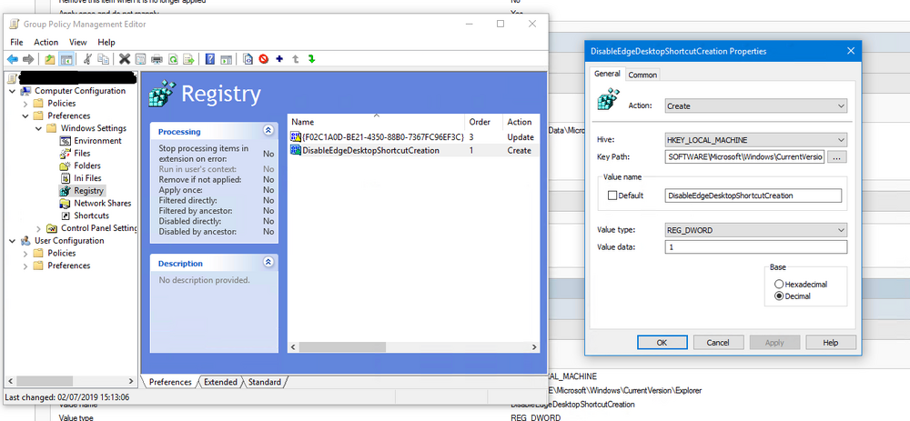

  22. Your looking in the local group policy editor there which will only apply to the PC your working on. Open the group policy management console on a domain controller and you should get the same options as in my screenshot.
  23. See below - I added to a computer GPO that applies to all our Windows 10 PC's. The full key path is: SOFTWARE\Microsoft\Windows\CurrentVersion\Explorer Hope that helps.
