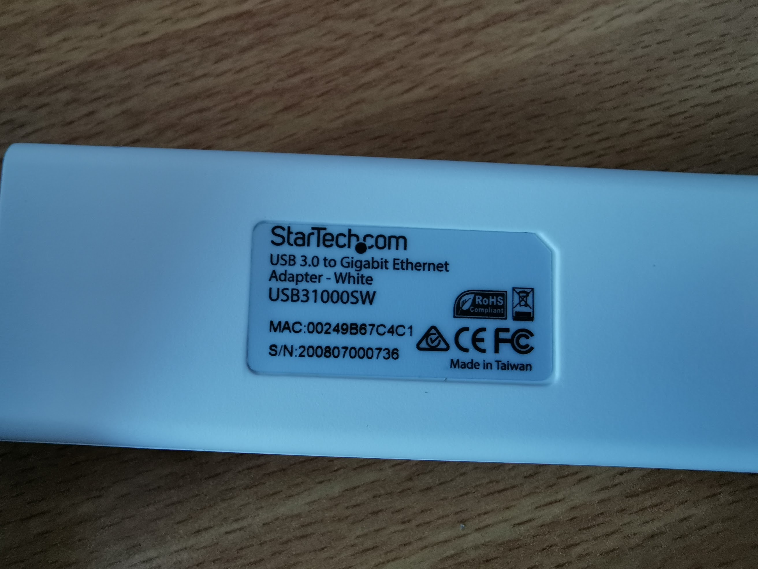

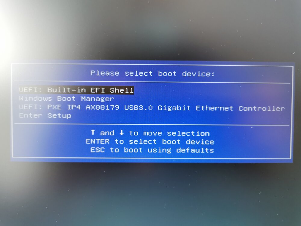

Hi,
I concur! I ordered a couple of different branded USB ethernets on Thursday out of desperation, including the StarTech. I'm back on-site today and the GE114 does indeed PXE boot from the StarTech. It also recognises it immediately at boot unlike the Realtek chipset based ones which don't appear until they are re-plugged, even with the latest driver which is meant to prevent this.
So for anyone else imaging these - you need the StarTech USB31000SW if you want to PXE boot them (or likely any other adapter based on the ASIX AX88179 chipset). I've tried two types of Realtek based ones, a TP-LINK one and this is the only one that works so far.
Hi,
