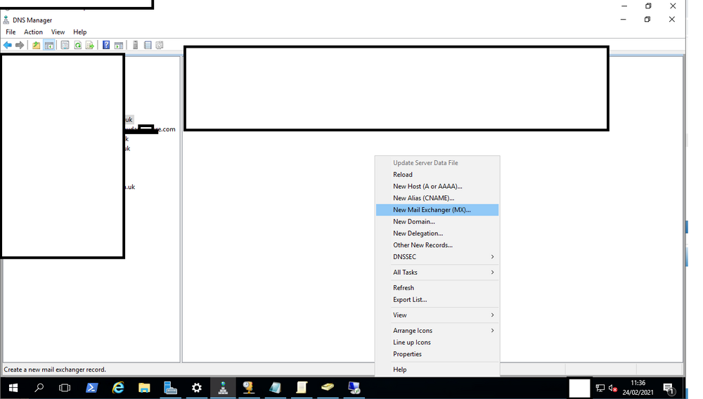

Jcx500 Posted February 24, 2021 Report Posted February 24, 2021 Add mx records to your dns hosting provider, or internal dns, For Your internal dns if you are running ad, log onto your dc and navigate to dns manager select the zone and add a new record 1
NetwM Posted February 24, 2021 Author Report Posted February 24, 2021 Add mx records to your dns hosting provider, or internal dns, For Your internal dns if you are running ad, log onto your dc and navigate to dns manager select the zone and add a new record[ATTACH=CONFIG]60948[/ATTACH] Shall add this to my dns hosting provider In order to set up your domain MX and A records for use with an Exchange server you need to create two new DNS records like this: Record 1: Domain = "yourdomain.com" Type = A Data = "Your exchange server's external IP address" in my case my public IP 85.x.x.x TTL = 5 minutes Record 2: Domain = "yourdomain.com" Type = MX Data = "yourdomain.com" TTL = 5 minutes After about 5 minutes your DNS record changes should be reflected on the domain. At this point, try sending a test email. If you recieve it through your Exchange server the DNS records have been updated. At this point you should change the TTL of BOTH DNS records to a longer period, e.g. 24 hours. This will make queries to the DNS server respond faster.
