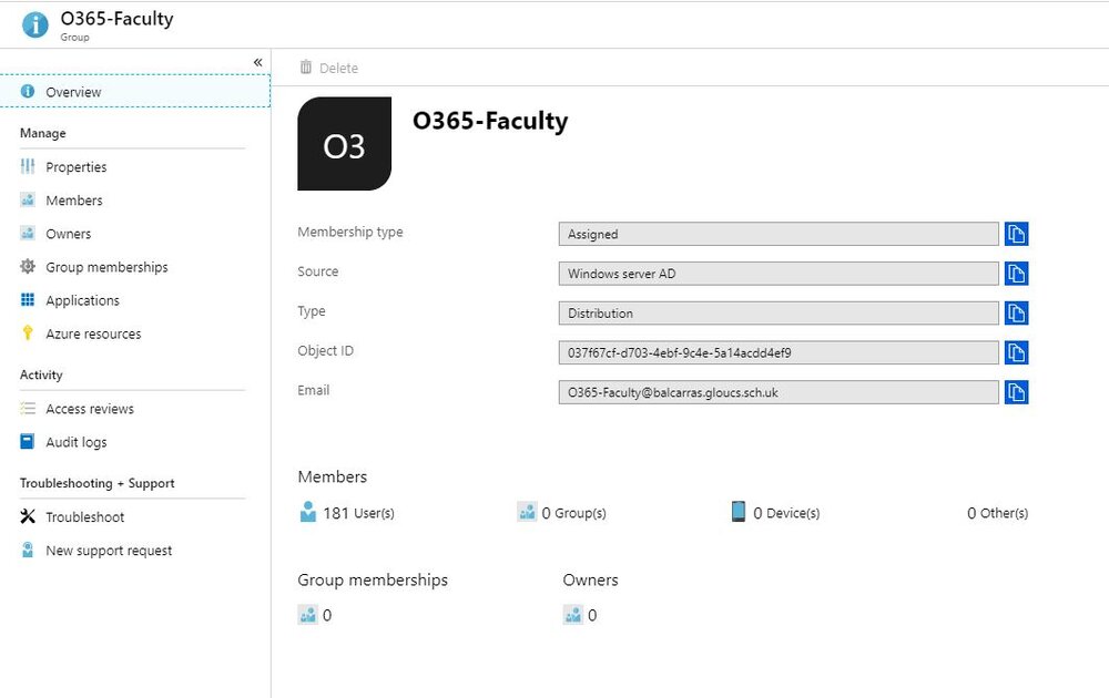

I've managed to successfully sync my two groups from AD to O365.
They are named : O365-Faculty & O365-Students
However I still can't locate them when I try to assign a licence - ideas anyone?

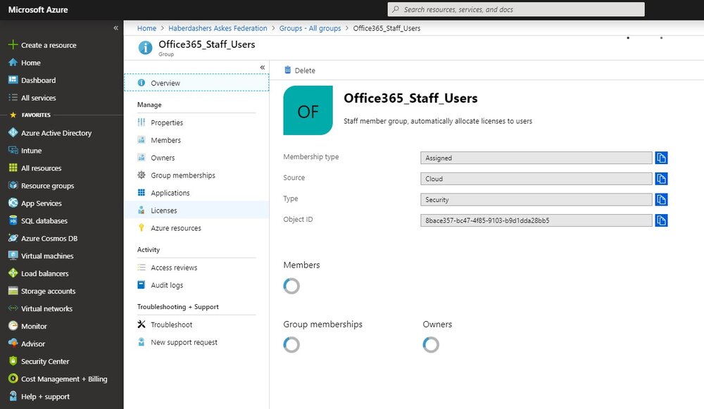

That's odd, licensing is just another menu item on mine:
This could be an access rights thing. What roles does your Azure AD user hold?

That group is a distribution group rather than a security group. That could be the issue.
Can I just edit the group properties in AD and change it to a Security Group?
