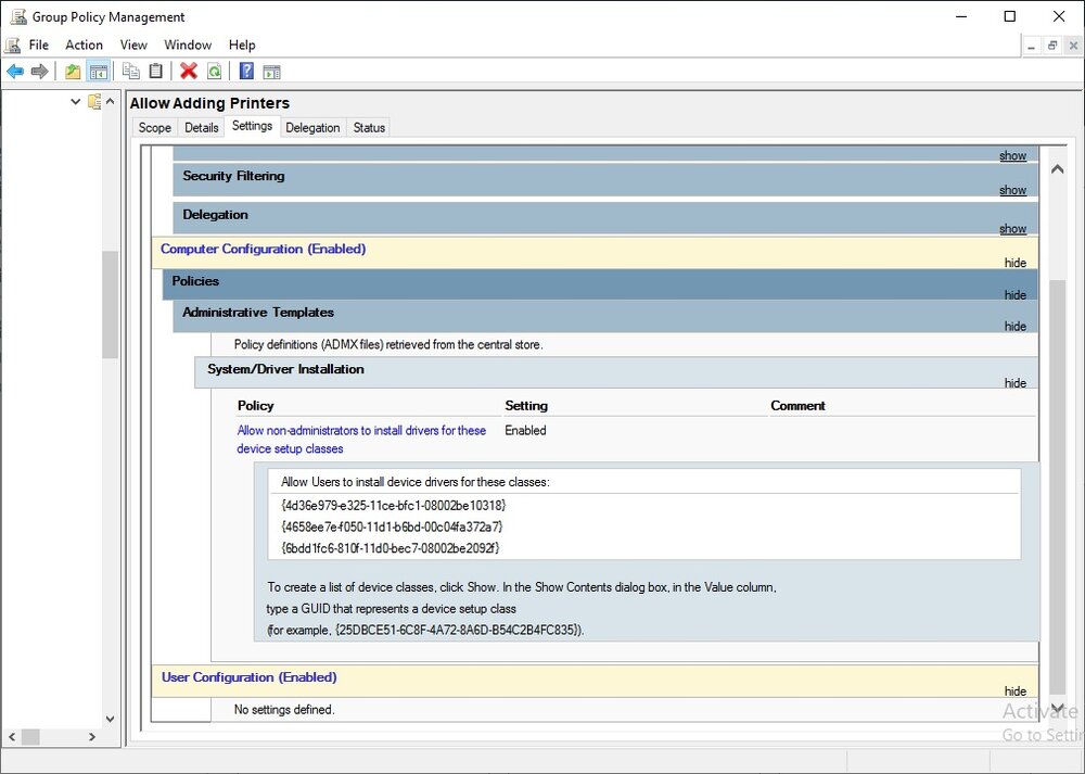

I would recommend you make sure you Bitlocker the laptops if they are going offsite. I would also not allow them local admin so they cannot install any rubbish on it. The issue here might come if they want to use their own printer for this I will temporarily give them local admin then revoke it the next day when the install has been done. They will be able to use the same domain login even if they are offsite using cached credentials I think this setting is on by default.
This GPO will allow users to install printers without local admin rights.
