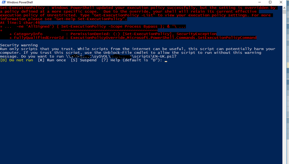

Am i missing something silly...
Do it as a single command:
Powershell.exe -ExecutionPolicy Bypass -File %filepath%
You won't get a prompt on this
I just swapped out the \\domain.net\ to \\pdc\netlogon and it worked now.

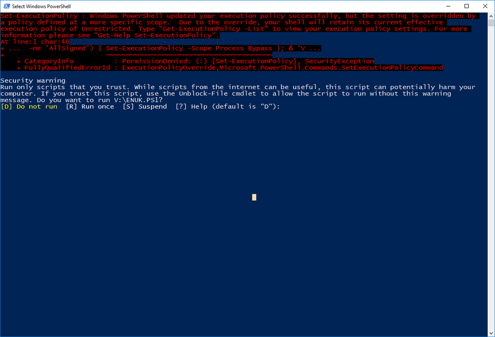

now i get a:
now i get a:
[ATTACH=CONFIG]42362[/ATTACH]
fixed with -force on the end...
Need to lean basic powershell i think...
