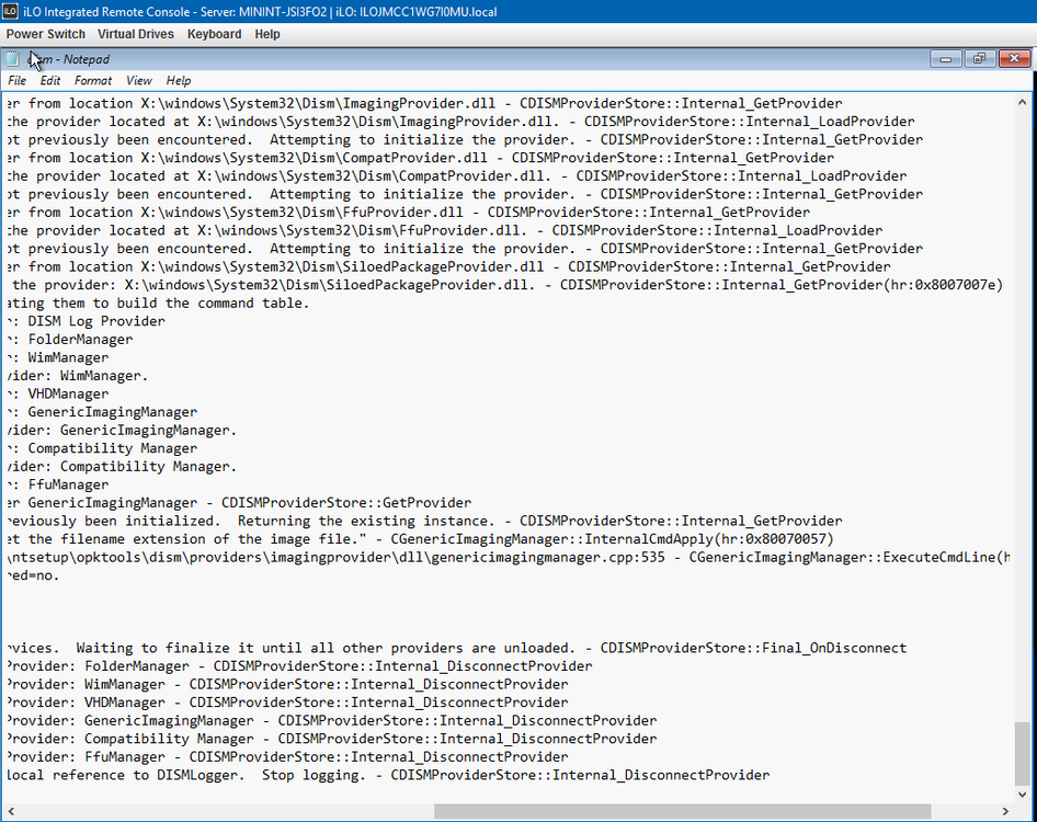

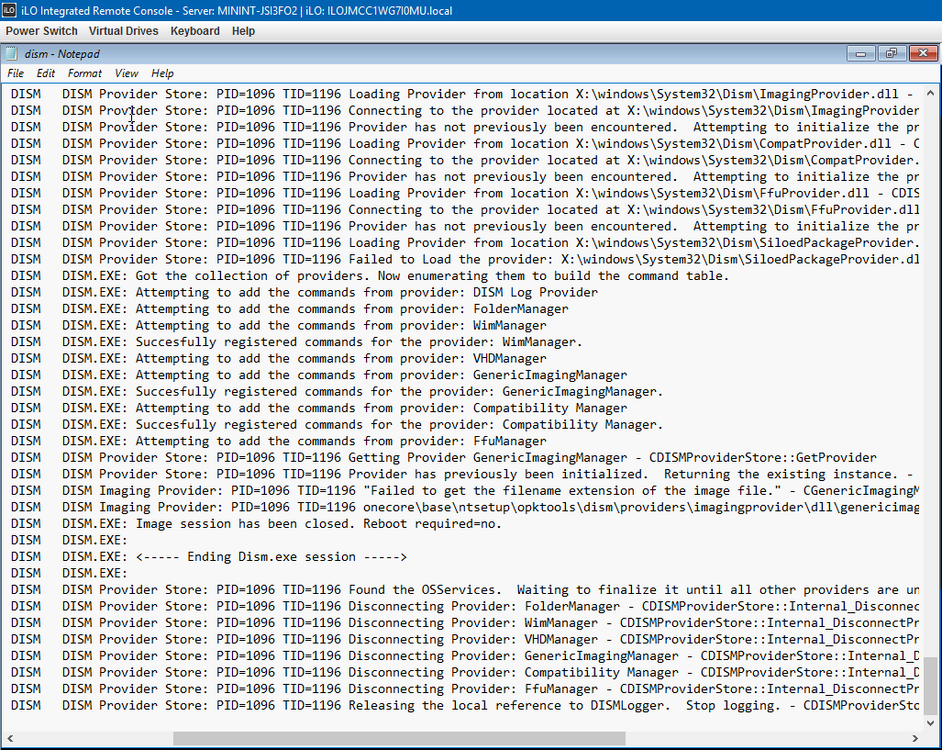

No, got exactly the same error:
X:\windows\logs\DISM>dism /Apply-Image /ImageFile:E:sourcesinstall.wim /index:1 /ApplyDir:C:
Deployment Image Servicing and Management tool
Version: 10.0.14393.0
Error: 87
The parameter is incorrect.
The DISM log filke can be found at X:\windows\Logs\DISM\dism.log
Do you have back slashes in your imagefile parameter? the full command should be:
dism /apply-image /imagefile:e:\sources\install.wim /index:1 /Applydir:C:
You may need to adjust your source path to ensure you're picking up the correct WIM (ie if you do "dir e:\sources\*.wim" do you get a list of files back)?
Thanks...I think we are getting somewhere...let's just hope it doesn't start freezing again once it is has installed!
