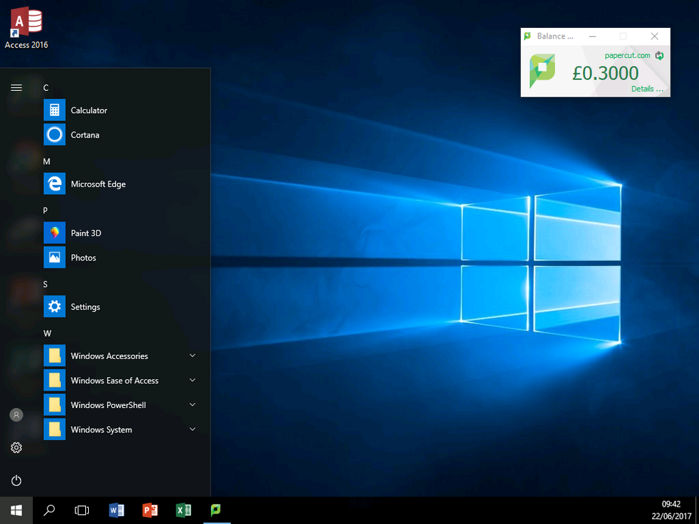

At this moment in time I've managed to get the start menu to redirect to a folder but it's still showing these two:
Settings doesn't open; but search does (whereas I don't want it there at all) and trying to remove these two annoying little so-and-sos is becoming a sanity destroying obsession.
Anyone get anywhere with removing these two from the menu? Or hiding them?
You can't hide them I believe, I've added them to applocker so they can't be opened.
