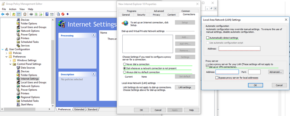

So, in theory, you could add a GPP (Group Policy Preference) to users and add a proxy via Internet Settings. I've looked, and you can't add it to a computer unfortunately (that I can see anyway).
The picture below should help locate the setting. I would suspect that you would need another GPP to take off the proxy once the time has passed, but I could be wrong.
For full closure, I've had little success applying internet setting via GPP, but worth a go!
That's where I apply the "standard" proxy. Just not sure how to apply it at set times. Also, wouldn't it all depend on when the GPO is refreshed? I'm not going to be popular if the first class of the afternoon has no net access!

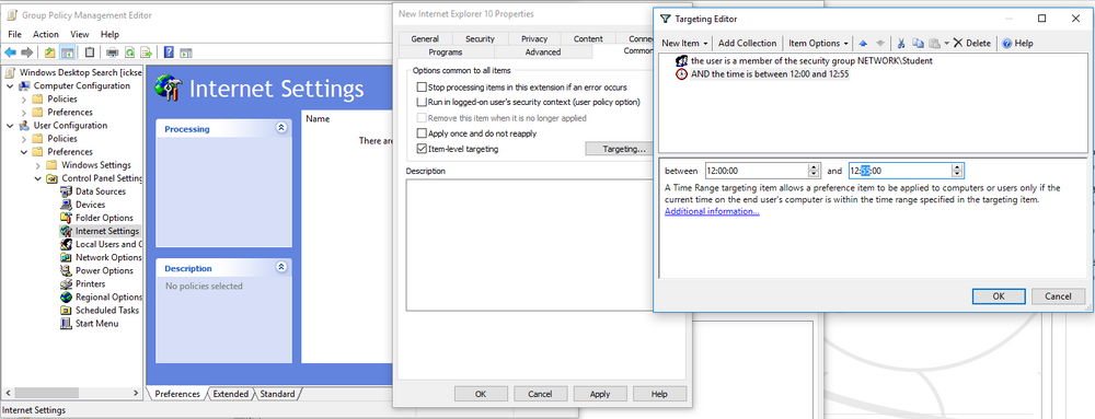

I would set another GPP at a higher level (so it takes precedence over your existing GPP, I believe that's how it works) that changes the proxy to something that won't work, and set the Item filtering like the below. You could also change the Group Policy refresh rate to every 5 minutes, and give your self a bit of leeway (say internet comes back on 5 minutes before the end of lunch?). And then I would test it as extensively as I could! You're absolutely right, you don't want students not being able to use internet for their actual lessons.
