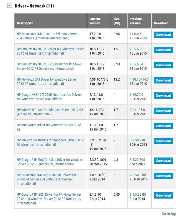

Yeah, it's annoying. We have two Gen 8 Microservers (and very capable they are too) but I wouldn't class them as enterprise level kit. More small office/home appliances and when you only get 12 months worth of firmware updates it's a bit cheap IMO, espcially given the cost of support.
My other gripe with the Microserver support is the downloads site. My PC desktop isn't the most tidy of places, in fact it seems to be overflow from the recycle bin mostly, but it's still more navigable than the HP site which is not only painfully slow, but full of irrelevent drivers.
For instance, the Gen8 Microservers come with three integrated NIC's as standard. 2x GB LAN and an iLO (remote management) port. These are standard on all models.
Yet the Gen8 Microserver download page NIC section looks like this:
And none of those correspond to what is actually listed in Device manager!!
It's the same over several other areas as well with storage drivers being just as bad. Come on HP please sort it out. We like your kit, we really do, but your support site needs a major shake-up.
[ATTACH=CONFIG]35544[/ATTACH]

I think HP's entire support offering needs work. From how much it costs, to how the site is laid out.
I mean, you built the bloody kit HP, you ought to know what hardware it went out the door with. If you ask me for the serial of the kit, don't then offer me a driver for every iteration you ever made, offer me the drivers that my kit needs!
