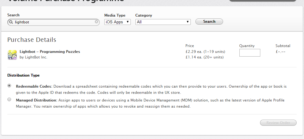

Thanks for the replies. The school has no purchased anything yet, but I need to make sure I know what I'm doing before they purchase :)
This is what appears when we find an app to buy.
https://i.gyazo.com/389d6a097c625ec70f2beb8615fe0f6b.png

No. An iPad does not need an Apple ID if it is Supervised (Also referred to as Managed). The option at the top-middle of Apple Configurator 2 'Prepare' (little cog icon) will make a device Managed (if you have no MDM, then just select Manual, and once you've made it Supervised, use the 'Skip Configuration' option in the iPad initial setup.
You can then create a Blueprint. A Blueprint contains information about the device name*, settings and apps. The settings are modified by creating a Profile (File, New Profile) which is then loaded into the blueprint (Add, Profile). Apps that have been purchased via VPP are added in much the same way (Add, Apps). Once you have your Blueprint set up as you would like, you can then apply the Blueprint to any iPads connected to the machine running AC2

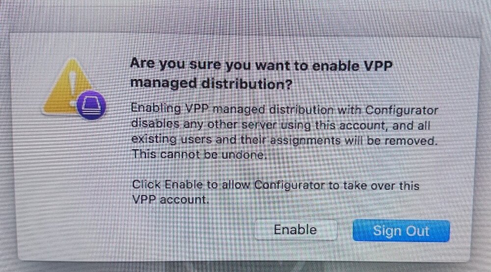

I've now logged into the store on AC2 with the VPP account, it pops up teling me I have to allow AC2 to mange the VPP account, that's good. I've not purchased any apps yet but if I click on the add app icon it tells me that the VPP account is being managed by another MDM solution.
Unfortunately I can't comment on that one, haven't ran into that issue. It let me sign in straight away, and we use* Profile Manager as MDM.

Situation I have now is that there's a variety of free and paid for apps locally on the mac. I can send them over to the ipads easily but when they run they ask for an apple ID. Looking at the apps in itunes I can see they have been bought with an apple ID somebody at the school has setup. It's not the VPP apple ID though. Regarding the free apps if I look to buy them via the VPP site it says:
"Managed Distribution: Free apps are only available in bulk using managed distribution. Assign apps by using a Mobile Device Management (MDM) solution, such as the latest version of Apple Profile Manager. You retain ownership of apps which allows you to revoke and reassign them as needed."
So does that mean I need to set that up? Or can it be downloaded and rolled out via AC2?
