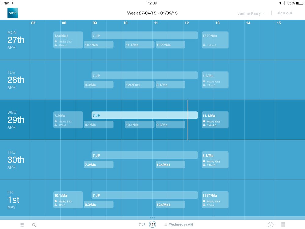

1. Our registration is showing up too late. Reg should be 7:30, with P! at 7:45, but it's showing as starting at 9 and running for most of the day!

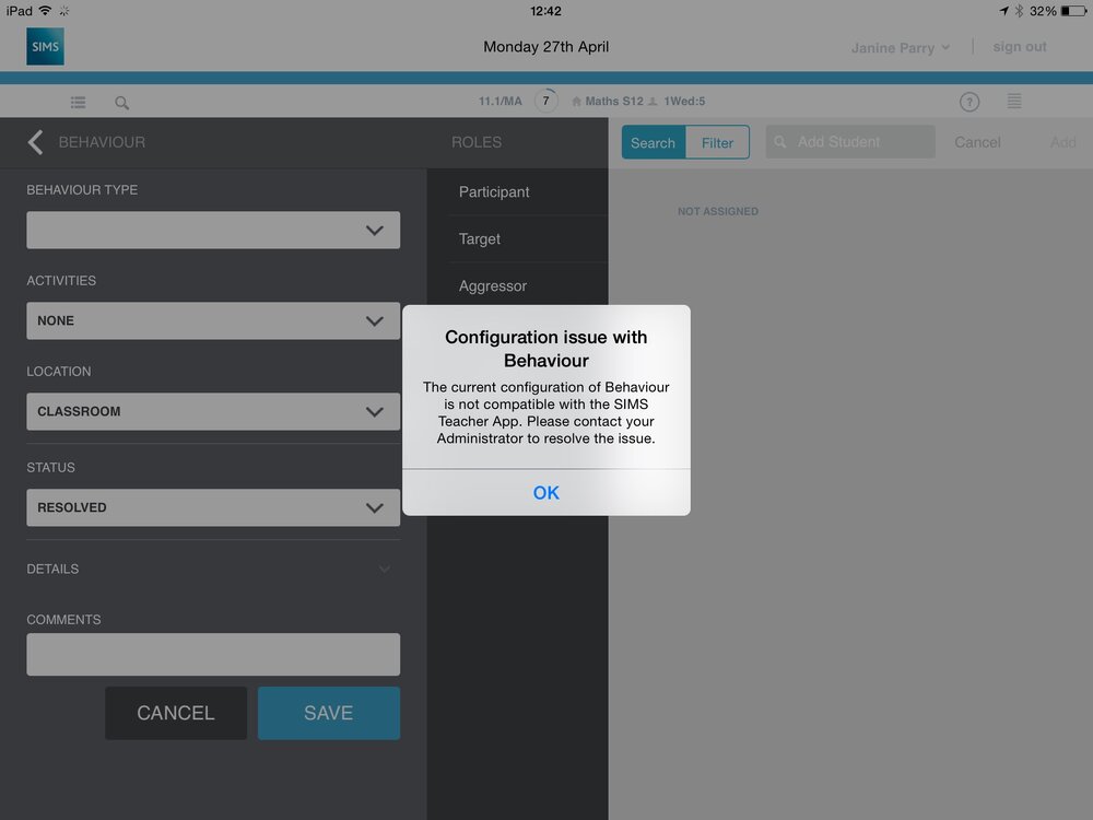

2. When trying to access the behaviour option we've been receiving a message informing us that we have a configuration issue with behaviour.
Has anyone had these issues before? How have you overcome them?

Is that the session reg? It does similar in the desktop SIMS doesn't it. It looks like it will extend all morning until your PM reg, but the first period height is blocking it. I could be talking rubbish, and you might have to run some routine to fix it.
I'd log a case with the support desk either way.

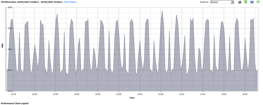

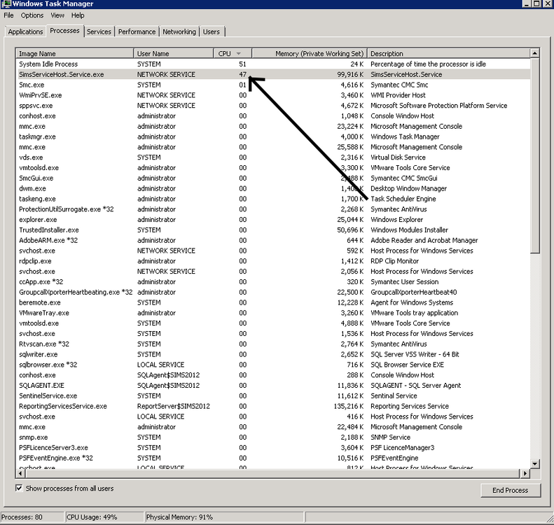

We STILL aren't using it after trying since it launched - after a couple of minutes of the service on our server running, the CPU maxes out (even though no-one is using the teacher-app) and stays that way until we kill the service. Still waiting for Capita to sort out the problem so we can get on with using it. Haven't seen what the app itself actually does yet!
@cullingsh - this relates to an issue we have picked up with the Microsoft Azure Relay Bus - the retry policy for connection has been impacting the server for a small number of schools.
Microsoft have released a patch update and we are now implementing into the app services - the team have it as a priority and will be working on this over the next 1-2 weeks.
It has impacted up to 5 schools I understand - we had to check to ensure it was not a SQL 2014 upgrade.

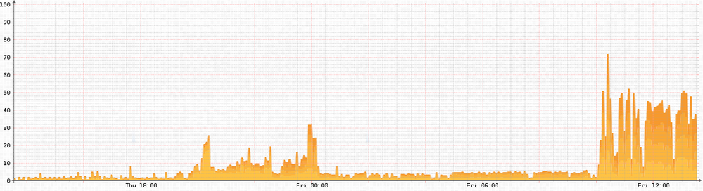

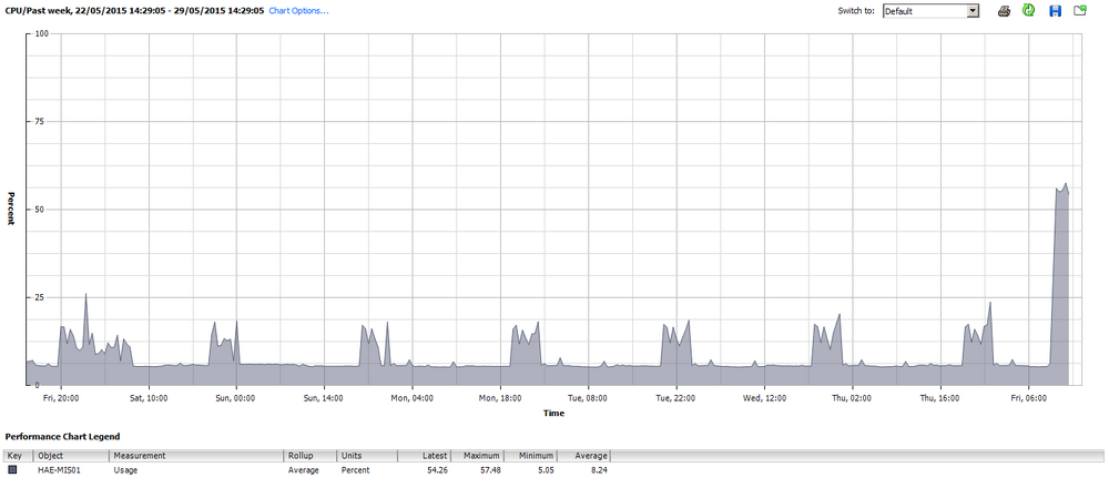

We've had the services installed for a couple of months now and encountered the same issues as being reported above, i.e. high CPU load, inability to access the app in the first instance and those that did have had varying levels of success.
Yesterday, after waiting for feedback on SQL logs I provided, Microsoft are apparently at fault and it is recommended that I suspend the teacher app services until the situation is resolved.
Consequently, we will be turning it off today and having lost all confidence with it, will probably never try again.

Coding/Test is now complete on the CPU Max issue and will be released in next 24/48 hrs. I think it's an infrastructure solution so will not require a download.

The CPU fix has been issued. We’ve integrated an update to the Microsoft Azure Service Bus binaries, which includes their fix to the problem. Schools will update to the newest version according to upgrade settings (by default automatically and at 2am).
