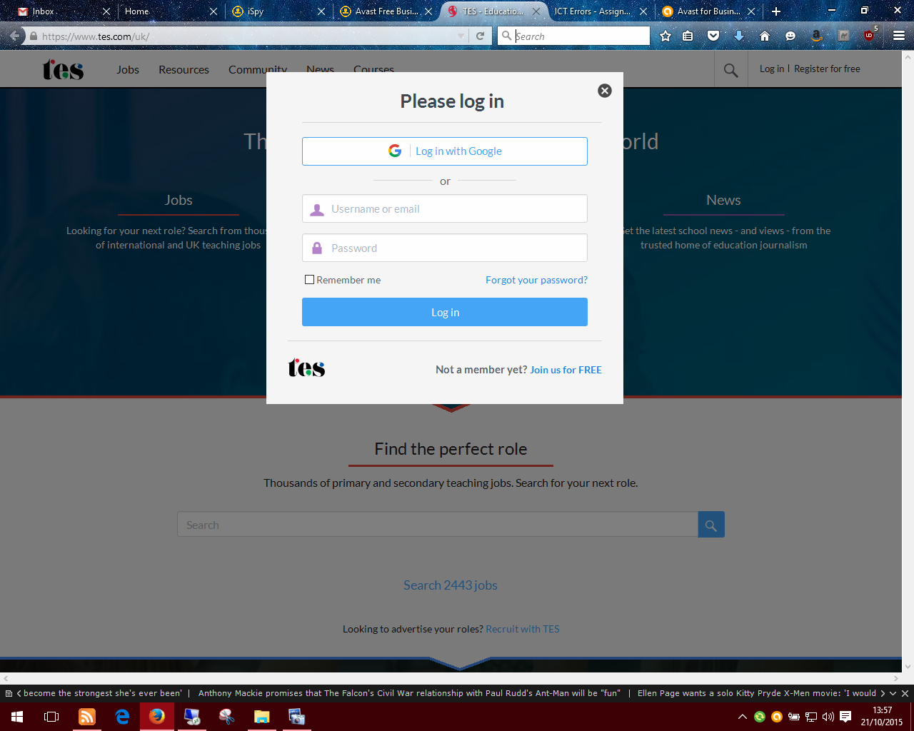

LeMarchand Posted October 21, 2015 Posted October 21, 2015 I tried TES on Firefox, Edge and IE. All get to the logon screen with no problem: Does anyone else have problems with clients not showing as updated in the dashboard even after an update task for them has successfully completed in Network>Tasks? 1
klop Posted October 21, 2015 Posted October 21, 2015 Thanks LeMarchand Strange though, if I add tes.com as an exception locally within the Avast software then it will work, but if added as an exception in the management cloud then it will not work.
