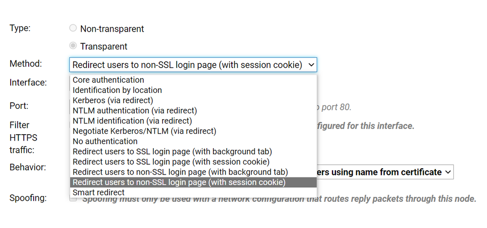

  17. So with ours setup as below, would you suggest changing it to redirect to SSL login page with background tab? I will be looking at the Radius side of things over Easter but need a quick fix or better fit right now.
  18. Hi there, our Smoothwall went live last week and I'm under the cosh to get a particular issue ironed out. The boarders, who started to arrive back yesterday are connecting to the SSL login page fine, but the sessions are set to timeout after 20 minutes. This makes it impossible for them to watch films and Zoom their parents etc without disruptions. What can be done about this? Many thanks
