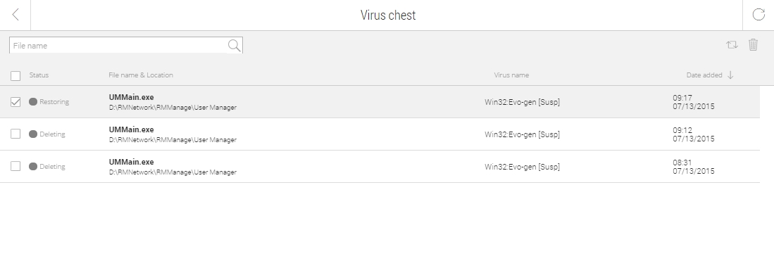

Hi All,
Just a quick update, came in this morning and for some unknown reason after a couple of months of running Avast on the servers with a specific template it seems to have quarantined a specific RM file which relates to the RMMC and this would not allow us to access the user properties in the RMMC, I have removed Avast from this server and re-installed the user manager legacy, until I can guarantee it will not start quarantining other files which are genuine I will not re-install, must have been the latest updates which caused it,
Will relay this to Avast but in the meantime the clients seem to be fine,
Watch out if you decide to install on Servers keep an eye open :)

It seems ok on vanilla servers without any other software ontop, I thought it might kick up a fuss on the RM servers but as I said it has been installed on Servers for a couple of months with hardly a ripple until today, anyway nothing too major all sorted again, will test further with different templates.
KTF :)

Yes they do, it has something to do with remote accessing the Postgres SQL database and the AD at the same time utilising the Usermanager UI, it seemed fine for the last couple of months and then wham!
It seems the last updates refined the file scanning, been running deepscan so will probably lighten this on the template before I re-install Avast, only affected the DC though as this is where the executable is run from,

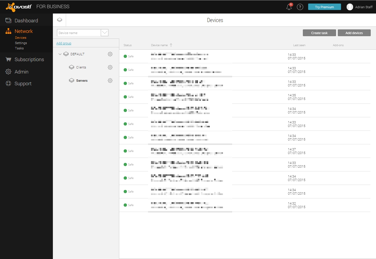

I'm part way through deploying to desktops. Is there any way to bulk assign to the correct policy?
I thought I could go into the actual settings and click > add device and it add it to the right group but seems there's no add device button now?

I have a bulk installer for pushing the client install out using PDQ Deploy but one has to manually activate all of them in the online console as they appear and then once activated add them to your client or Server template, that's how I did it, I don't know if anyone else has done it differently?
I set my templates up first as a clone of the default one with minor adjustments for both the client and servers, I have 3 templates one for clients, one for Servers and one for our TS servers.

I've figured it now, with the help of their fab support.
If you go here https://business.avast.com/#network/devices then press the option to show the groups pane. Create all the different groups and link them to a policy, you can then drag the clients into the right group and they'll pick up the right policy.
To begin with I was going in and editing each client.
