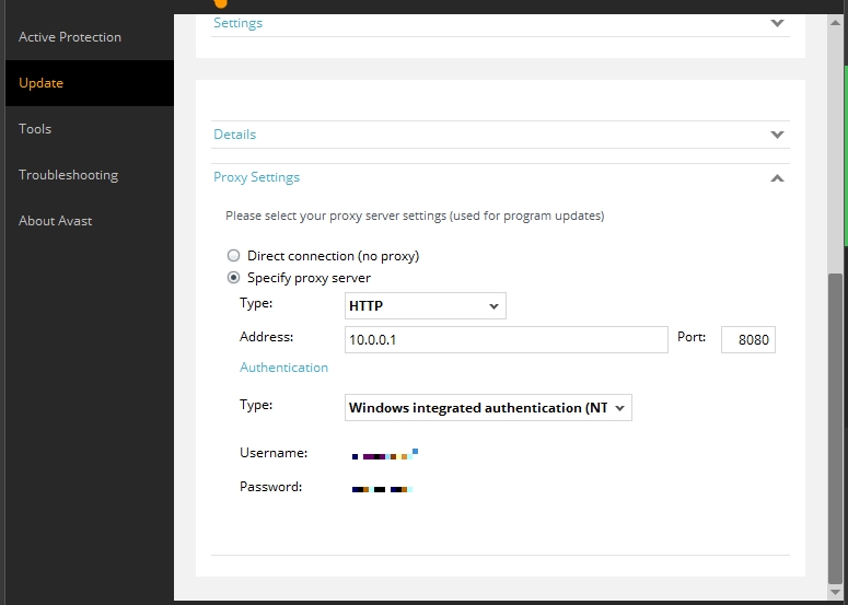

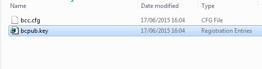

It seems to me that once it has registered each client is given a separate key:
Our config is online which when you look at the client Avast application under updates we see the proxy details:
All our clients are updating unless they are not on which Avast console alerts me to,

Update: I have found our proxy settings in here: C:\Program Files\AVAST Software\Avast\setup\Proxy.ini
Edited by bossman

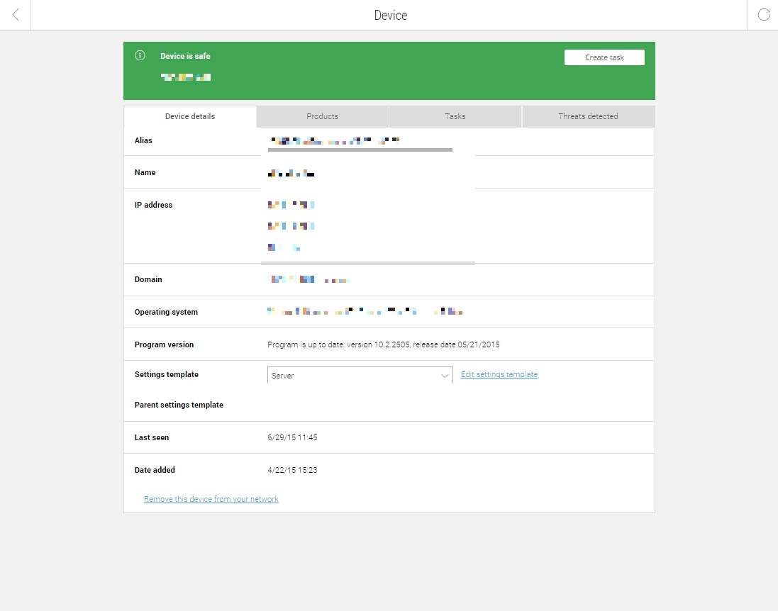

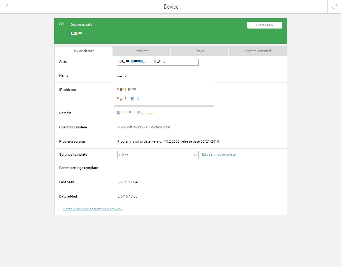

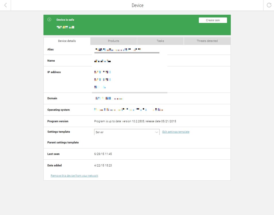

@pete
Below is a sample of Server and Client settings in the console:
Server:
Client:
As you can see from the dates first installed to present day all correct and the last seen was today at approximately the same time, both units have the latest updates of the program which was released as per the date, all Computers and Servers are the same except one HP Netbook which hasn't been used by a student for the past week.
