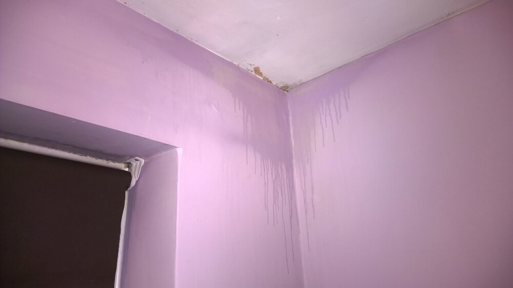

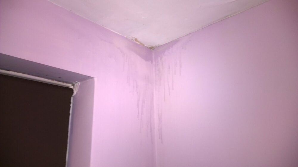

I'm after some advice as I seem to have an ongoing leak which is coming through the roof in my bedroom. I had the same problem over the last couple of years and had some repairs done (cracked tiles replaced and some edging done) by two different builders but the problem doesn't seem to have gone away. It did seem like it had, but I can't tell when the problem actually comes. It was pretty bad a couple of weeks ago and I am trying to get someone out this weekend to look at it, but basically I wanted to know if anyone had any thoughts on where the water was coming from. I've been into the attic and can't see anything obvious but the last 2 days in the morning it has been pretty bad, but by the time I have got home from work it seems to have dried out. This was taken when I got up yesterday WP_20141203_07_39_50_Pro.jpgWP_20141203_07_40_02_Pro.jpgWP_20141203_07_40_26_Pro.jpg The first 2 are from each corner of the room and the last one is above the window.

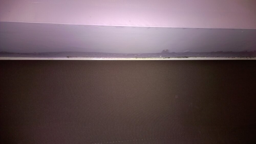

Again this morning I found it like this:WP_20141204_07_34_41_Pro.jpg As you can see there is fresh water but as far as I can see there was no rain last night (or very little) so I'm not sure where this is coming from.
Has anyone had anything similar or could suggest reasons for this happening? I know that water can travel, but I would like to get this sorted and if anyone can think of reasons I could check or even ask someone to check when they come round it would be much appreciated.
Thanks

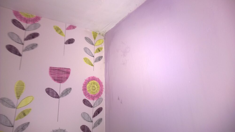

One other thing to add is that the house is a semi and the worst part is where we are connected to next door but I couldn't see anything obvious coming from next door and there is a wall in between the two attics.

From the amount of water and the location i don't think it's condensation. I've experienced both loft condensation and a leaky roof and they are both very different. The whole of the loft got damp with condensation as opposed to a damp corner of my room. Unless you have plastic sheet lining your loft for some strange reason the warm air will condense on the back of the felt inbetween the rafters rather than pool in the corners

It's only happened recently so I assume it is weather related, as I said we did have this problem before but thought it was due to cracked tiles which were replaced. The thing that is puzzling me is that fact that it has been the last two mornings and the weather hasn't been that bad - certainly last night I didn't think we had any rain.
@Sunnyknight - the reason I haven't started hacking away at things is because I'm not confident of what I would be doing and don't want to make things worse but if I have to do that I will.
