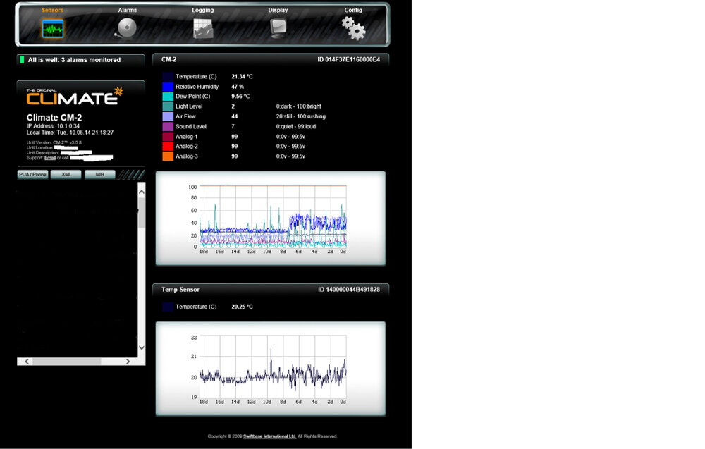

Just had the a\c fail in our server room, I only noticed as one minor switch packed up! Does anyone have a monitor that would email out when it hits a threshold?
We've got a CM-2 from The Climate - it's setup so it sends a SMS text alert (via an e-mail gateway) if certain thresholds are exceeded. Monitors Light, Sound, Humidity and Temperature out of the box but you can add extra sensors and cameras on it.

Same here.... Very good piece of kit!
I have Temperature @lert it is a USB device that will send emails for high and low temps.

You might be able to configure nagios to do something - maybe using the server motherboard/ambient temp sensor?
Some switches can also monitor temperature - I don't know if there's some way maybe of using snmp to monitor that, again maybe with nagios or similar.

We've got a monitor that plugs into our APC UPS and monitors temp via powerchute, it performs shut downs based on a temp threshold set in the software.
We lost Aircon a few months ago as sites were working on the electric and had the phase off on a Saturday (didn't tell IT) and they forgot to turn it back on again, the first we knew was when the Equalogic SAN's, EMC SAN and blade centres started emailing about temperature. This would have been picked up in the week but at a weekend it was lucky that I checked my email when I saw 130 new emails on my phone.
This highlighted the fact that we needed propper warnings so the BMS system has now been configured to automatically SMS message the duty caretaker, head of IT and head of estates should anything happen again as this has temp monitors in the server room but nothing had been configured, and the APC module bought for the UPS.
We were lucky in that we didn't loose anything despite seeing intake temps of 70 degrees reported but it doesn't mean that the serviceable life of components hasn't been reduced and we will get premature failures down the line.

I've been looking at the offering from Ubiquiti - mFi. Could get an mPort, and temperature sensor for less than £100. Could then add another two sensors to the mPort to make more use of it such as a PIR/door sensor so we could log when the server room door is opened or movement in there, or a current sensor so we can monitor power usage of the UPS and equipment.

We use The Climate as well, its good.
Whenever we had a power cut at school (we get quite a few!) the air con went off and didn't come back on, so the tempreature just went up and up hence the climate monitor. The monitor is on one of the UPS, so it keeps going even when there is a power outage.
Since then, I have managed to get our air con engineer to re-program our air con unit so that it reverts to 'last-known state' (i.e. power on) when the mains power is restored and so as soon as the power comes back on the air con wakes up :D
The aircon engineer told me that most aircon units are capable of that, but he did download a software (firmware?) update for ours when he sorted it out, so may be worth asking your engineer next time they come to service the unit.

We have a CM2 here and the interface is very similar, my guess would be the hardware is the same, just running their own code. Can't fault the device at the moment, just be careful when ordering external sensors, some plug straight in, others need additional adapters.
