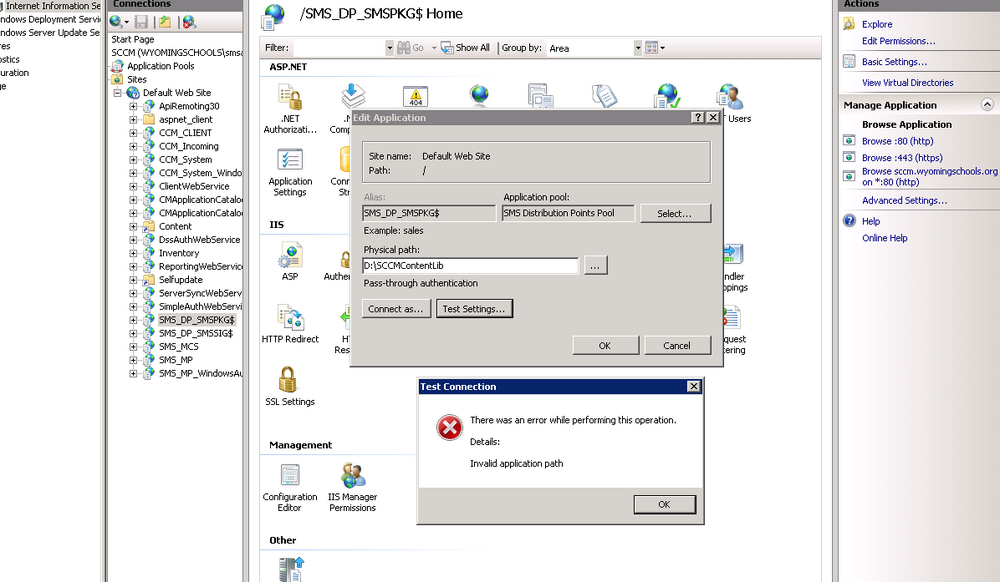

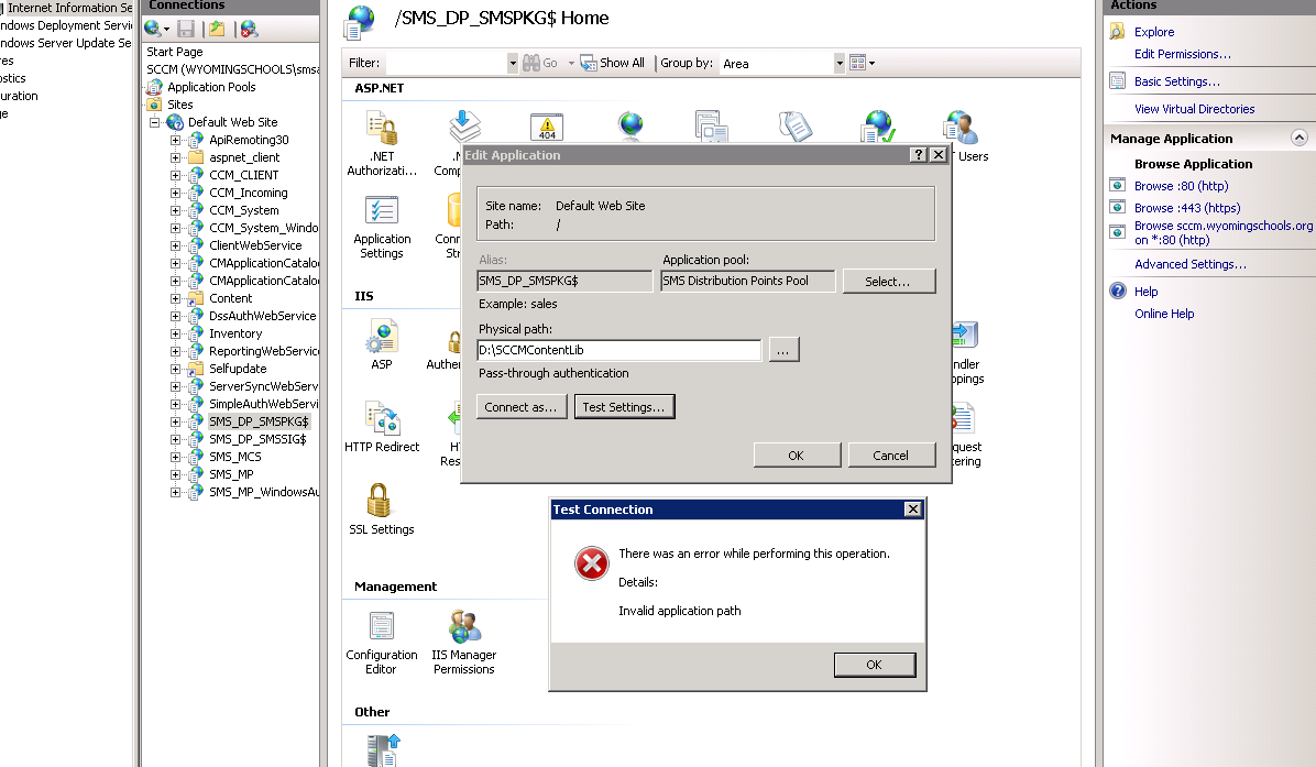

SCCM 2012 - Apps Stuck at "Downloading 0% Complete"
scottpowers82 replied to scottpowers82's topic in Enterprise Software
OK, so I have now re installed my DP role and redistributed all of my content. Everything seems to look OK now in the Distribution Point Configuration Status (All is Green!). However, I am still unable to download most of my content to the client. I am definitely leaning towards it being an IIS/WebDAV problem, but have not had much, if any, expierence with IIS (other than maybe a simple FTP server). When I check under the IIS Manager and check the Basic Settings of my SMS_DP_SMSPKG$, my physical path seems to be correct. However, when I click on Test Settings, I get the error Invalid Application Path. Anyone have any ideas out there? Thanks in advance... -
OK, I don't think it has anything to do with the fact that my content is coming up as failed. After going into the properties of my DP, I went into the Content tab and actually removed some apps that were coming up as failed. I then Distributed them again and they finally come back as green! I thought my problem may be fixed and they I can just remove/re-add them, but when I went to my test machine and tried to install an app (that is now green finally), it still shows as Downloading 0% complete. Bummer -

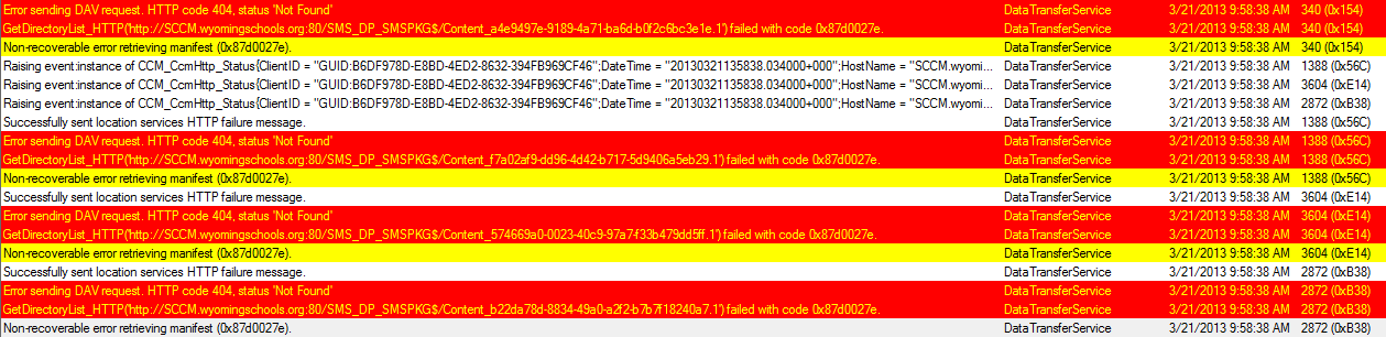

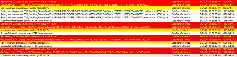

Sorry for the long response. I have our wireless networks setup as a boundary group and assign them the slow connection type. I figured for wireless, it might be better to use slow for bandwidth issues when 30 kids are logging in at the same time. Or is it meant more for WAN type connections? Is wireless fast enough for the fast setting typically?

AH HA! Think I may have figured it out. Currently, I have all of our wireless network boundaries set to use a slow connection type. I have the content type for this application set to MSI and (under the Content Tab from the Deployment Type) the deployment option was set to "Do Not Download Content" if using a slow network boundary. I then changed it to "Download content from distribution point and run locally" and that seemed to do the trick on my test machine. I'll keep an eye on it today and, hopefully, I'll see it deploying to the rest of my clients throughout the day. Anyway, just wanted to post the fix in case it helps someone else...

Hey Everyone, I have been pulling my hair out trying to figure this problem out as I just can't seem to find the right solution to my problem. So, here's the basic info: - I have setup an SCCM 2012 Server with all of my boundaries (using IP ranges) and boundary groups set. - When I deploy an Application (in this case, I'm trying to deploy a small MSI), it seems to work OK on desktop machines that are hard wired into the network, but when I check the install on a teacher's laptop, it keeps saying that it is downloading, but never moves past 0%. To make matters even more confusing, it does seem to work on a couple machines here or there (for Example, when I deployed my MSI to 127 teacher machines, it installed only to 4%....it is possible they may have been wired in though for some reason...not sure on that one) - Most searches I find for this topic on the internet keep telling me to check the boundaries, but everything seems ok to me that I can see. - If I try it in a VM (which would simulate Hard Wired), it works perfectly. Just not on wireless machines. It's gotta hopefully be something simple, but I just can't figure out the problem for the life of me. I was really hoping to move all our software distribution away from group policy and completely centralize most things I do into SCCM 2012, but this part is definitely holding me back. I just started getting into SCCM this past Summer, so I'm still a noob when it comes to it and may be missing something obvoius (I can only hope), but I would really appreciate any advice anyone can give me. Thanks
