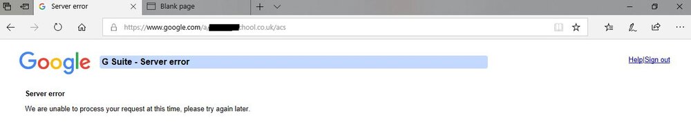

I have GSuite configured for SSO with Azure AD (where on premises AD is the source, synced with Azure AD Connect to Azure AD) using SAML. The sign in seems to be working; signing in with [email protected] from https://www.google.co.uk redirects you to the MS login page where it asks for the username again. You then enter your AD password and it directs you back to GSuite. However, there's no access to any of the services. The only message is Server Error We are unable to process your request at this time, please try again later. There is a link to sign out and if you click it, you are redirected to the MS "You have signed out - please close all browsers" page. If I manually create users, it seems to work and for some pre-existing users, but I can't work out a pattern. I'd really rather not delete all of the accounts and start again, as there's data associated with the accounts and I'd want to keep the same user names. Any ideas on where to start looking? Screen shots attached
