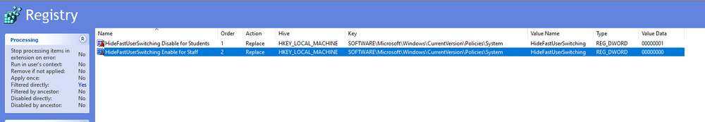

  19. Morning all I have a GPO which enables and disables the switch user option depending on who is logging on. Since moving to 20H2 I have noticed it has become hit and miss as to if it applies even thought the registry key appears. Anyone having issue or come across this? Cheers
