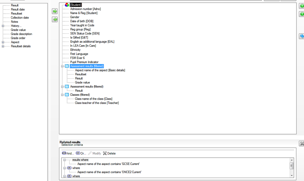

  9. As LosOjos suggests there are grids in SIMS that will do it per class or course - I would use a Chance Analysis for this. I also use aspects to collect the result for each subject as it is difficult to use the Examinations aspects because they have complicated names. Eg 'Ma GCSE result' instead of 'OCR J562 Result Grade F' etc. One other thing I do is use a grade difference aspect for each subject, eg Ma GD, that has grades defined as -6,-5,...0,..+4,+5,+6 with the same values that is recorded for every grade that is collected by result set(I use a result set named 'GCSE result). I would consider doing this for the result against the prediction and then working out a mean per class and also a grade distribution per class. Lot of work.....

  15. Not sure if this helps but I use the approach outlined above to get specific results into normal reports in SIMs that are fed into customised Excel templates to do all of the work. You can get any data you want so long as you can identify the aspect, result set etc.

  18. I use a report in SIMS that puts the data into a customised excel template. The transition matrix is produced automatically each time I run the report, just have to select the year group and the result set for the data. Would recommend you attend the advanced reporting course Capita run. You can also use a Chance analysis in SIMS.
