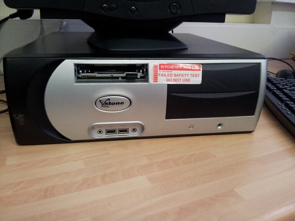

DrCheese Posted April 13, 2012 Report Posted April 13, 2012 Hi Guys, We've just had a PAT test done over the holidays here and the testers have decided to slap great big "Danger, unsafe appliance" on computers that have damaged faceplates. Where do we stand with this? The company that dealt with it previously never failed equipment based on this, so we never saw it as an issue. Short of replacing faceplates that will just get damaged or removed again, Where do we stand legally on this? (i.e if we continued to use the kit regardless)

DrCheese Posted April 13, 2012 Author Report Posted April 13, 2012 (edited) Whilst the PAT testers are 'supposedly' the experts what is your view on how dangerous the PCs are? Well they are all Dell GX620/745's SFF's so whist yes you could stick your finger in and touch the RAM, You'd really have to cause a lot more damage to harm yourself doing so. If someone wanted to do that, having an intact faceplate wouldn't really do much. I generally consider it cosmetic damage, so it's frustrating that they've slapped failed stickers on them. We've tried in the past to fix them in place but the students always find a way to push them out again. In some cases they've snapped the little divider between the two faceplates, meaning we can't just stick them back in, we'd have to replace the entire front. We've sorta given up for the moment and will learn from the experience when we next refresh our stock (soon) Edited April 13, 2012 by DrCheese

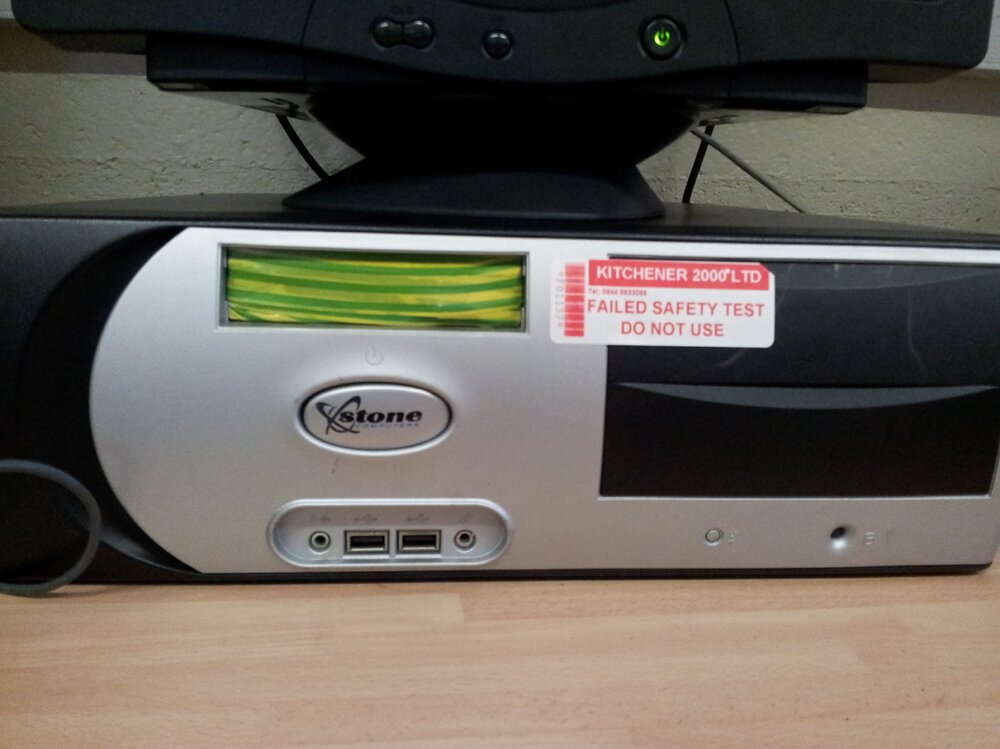

Grey-gear Posted April 13, 2012 Report Posted April 13, 2012 (edited) I've had a lot of that in the past, all I did was get the dt tech to cut out some lovely green plastic covers for the missing sections and then me and the other technicains super glued them on. Who do you think is more to blame the students or the teachers that "don't see it" when they are in those rooms? My boss riase this with the head of IT and the head explianing that if it continued that there won't be many lessons that will be using computers, it soon stopped. Edited April 13, 2012 by Grey-gear
