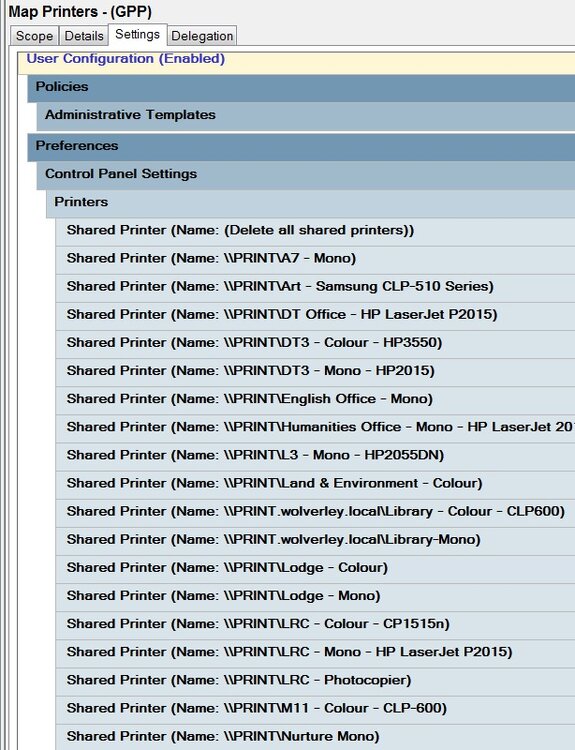

In our group policy to deploy the printers we have all our printers deployed in one large policy at the domain root with our domain default policy, then the printers are assigned due to the OU or security group etc. (See screenshot). Do you guys have separate GPs for each printer? Is this the way that other have successfully used GPP to printers?

I am now splitting our one "Map Printers" with 48 printers in, down to 48 individual GP objects that will apply to OU`s.... :(

Ive now split our one large GP down to individual GPs, and changed the server address from "PRINT" to "PRINT.domain.local".
I now seem to be getting 2 sets of the same printer... will keep at it.
