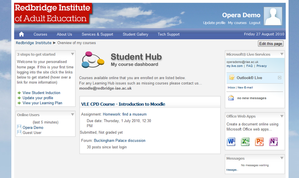

You can however link live@edu to moodle which is good.
