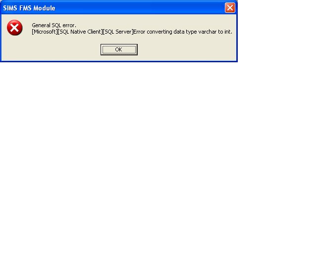

ben_snclc Posted December 10, 2009 Report Posted December 10, 2009 Hi, We are running SIMS FMS version 6.91 here and for some reason we have recently encountered an error with our SIMS. When we are processing our purchase orders and press the print option the machine crashes out and we get the following error message: "General SQL error. [Microsoft][sql Server]Error converting data type varchar to int." Has anyone any idea of what could be causing this problem? It sounds like it is some sort of problem with a field that is trying to convert from one type to another but the SIMS FMS works fine if we remote desktop to the server? Has anyone any ideas on what could be causing this? Ben

ben_snclc Posted December 10, 2009 Author Report Posted December 10, 2009 It prints the Purchase Orders out fine but then i get the error message. Here is a screen print of the exact message. So printing is fine whichever printer I use and printing is fine, its just after printing happens and it tries to save the file this is when the error message pops up.SIMS Error.bmp

garrysaddington Posted December 10, 2009 Report Posted December 10, 2009 This error message tends to suggest that there is a data type conversion of varchar to int that is starting with data that is not in an integer format, eg. 2.5 cannot be converted to an integer. Either the original input data is invalid or the SIMS programming, I can't tell which.
ben_snclc Posted December 10, 2009 Author Report Posted December 10, 2009 Thats what i thought. Its strange because everything was fine until some MS updates kicked in on the machine and messed with something. I copied the latest FMS files from the server and the error went away. We will test a bit more before finally closing the door on this one. Cheers, Ben
