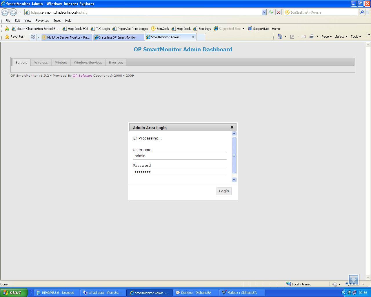

mullet_man Posted November 18, 2009 Posted November 18, 2009 (edited) Yet again I have messed up, I have backed up the whole folder and tried to do the update, and couldn't get logged into the admin area, it just hangs at logging in. This is the same if I try and start a fresh website. See attached, this is from starting a fresh. Edited November 18, 2009 by mullet_man
ICTNUT Posted November 18, 2009 Author Posted November 18, 2009 Can you download the upgrade pack again just made a quick change, my fault sorry
mullet_man Posted November 18, 2009 Posted November 18, 2009 Can you download the upgrade pack again just made a quick change, my fault sorry Still nothing!!! I downloaded from the link again, and started a fresh.
ICTNUT Posted November 18, 2009 Author Posted November 18, 2009 (edited) Have you editied the settings.asp file in the incs folder? Also make sure you don't have any cached files in your browser as that will cause a problem. Edited November 18, 2009 by ICTNUT
mullet_man Posted November 18, 2009 Posted November 18, 2009 Yes I have edited the settings.asp file with a changed admin/pass for the admin area, and also domain admin settings. I am starting from a new site in IIS.
ICTNUT Posted November 18, 2009 Author Posted November 18, 2009 I note from your sceenshot that you have nothing visible in the background behind the login screen are you starting from a clean database as well?
mullet_man Posted November 18, 2009 Posted November 18, 2009 Yes, I wanted to start again. I failed the attempt to do the upgrade.
ICTNUT Posted November 18, 2009 Author Posted November 18, 2009 Ahh right that makes sense then, let me just run through the setup here on a new site just to check
