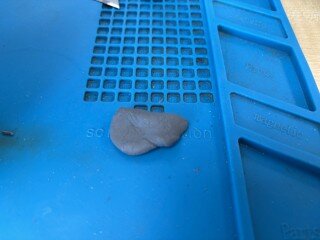

I will echo, and strongly repeat once again about wearing gloves.
Before curing, It. Smells. Of. Rotten.Pee.
And no amount of washing your hands will get rid of it!

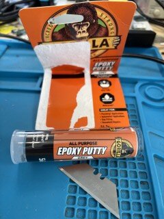

1 minute ago, 3s-gtech said:
That's similar to JB Weld isn't it? When used correctly, you can do some ridiculous repairs with this stuff.
Not sure as I came across Epoxy Putty on a random YouTube repair video and when I searched Amazon for it, Gorilla was the only brand I recognised! 🤣

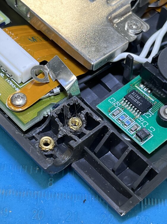

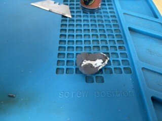

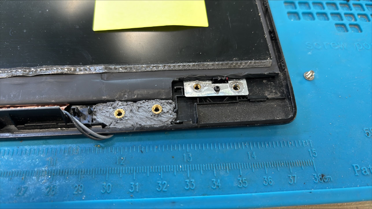

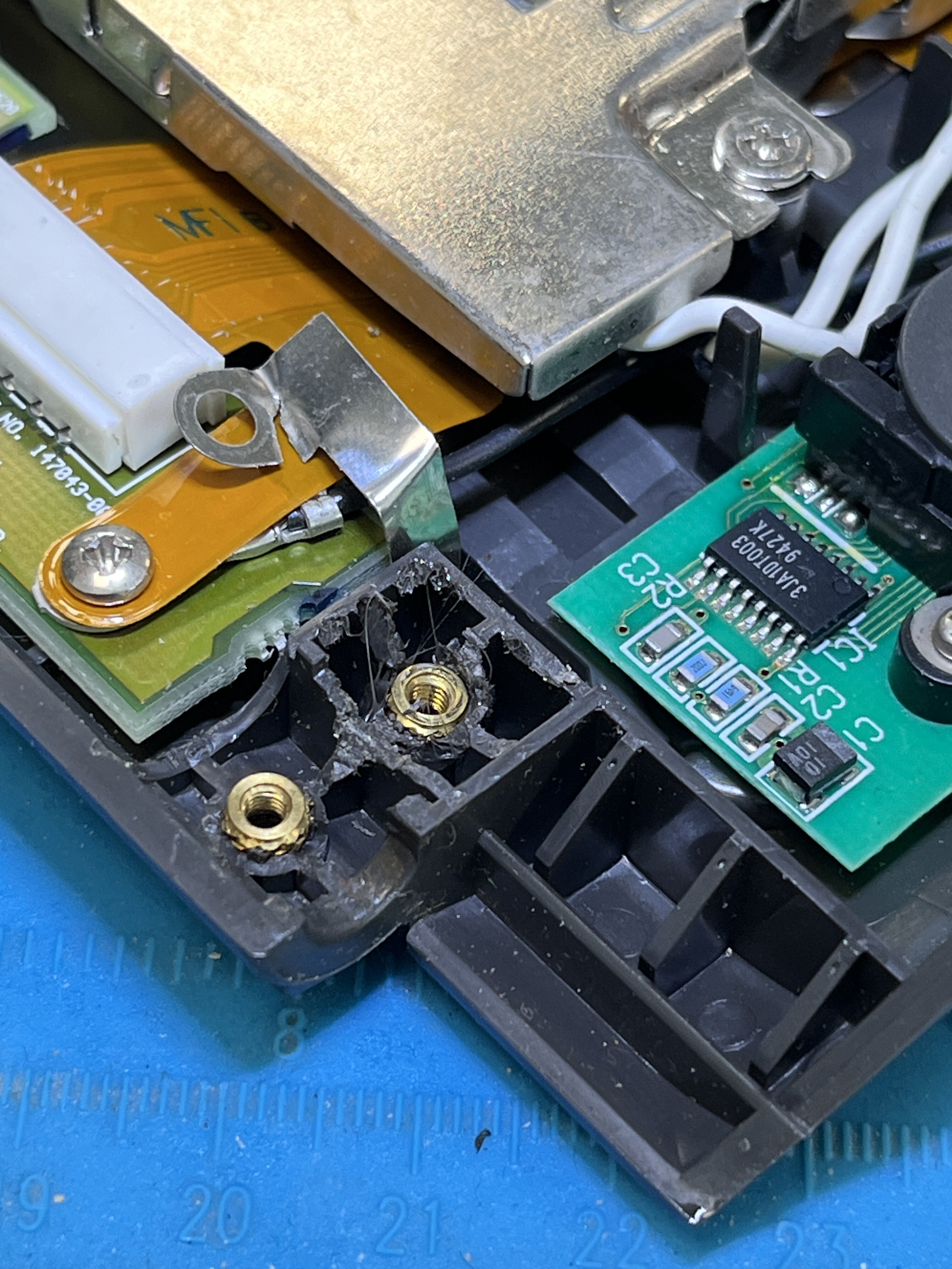

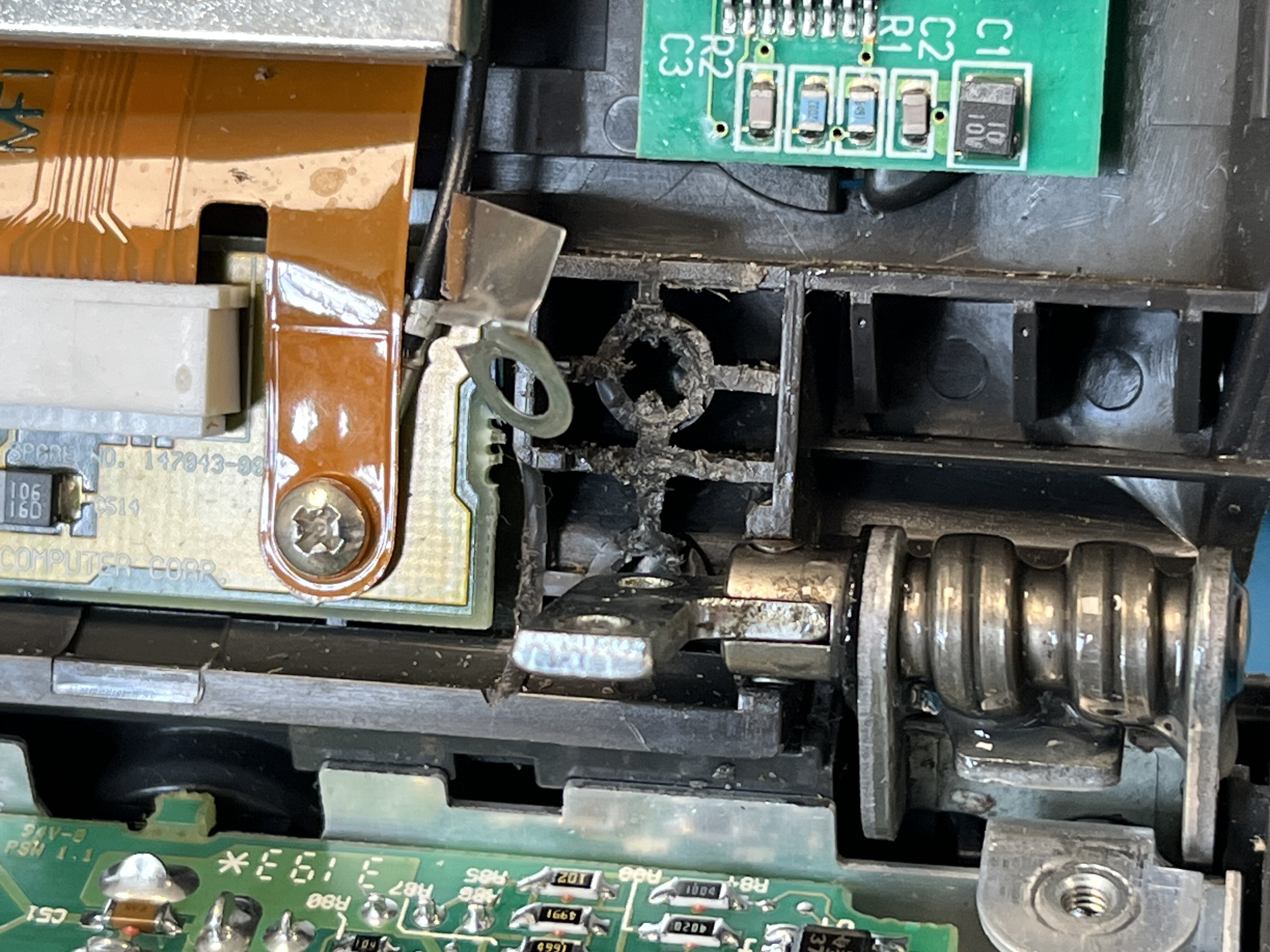

I've found another use for Epoxy Putty!

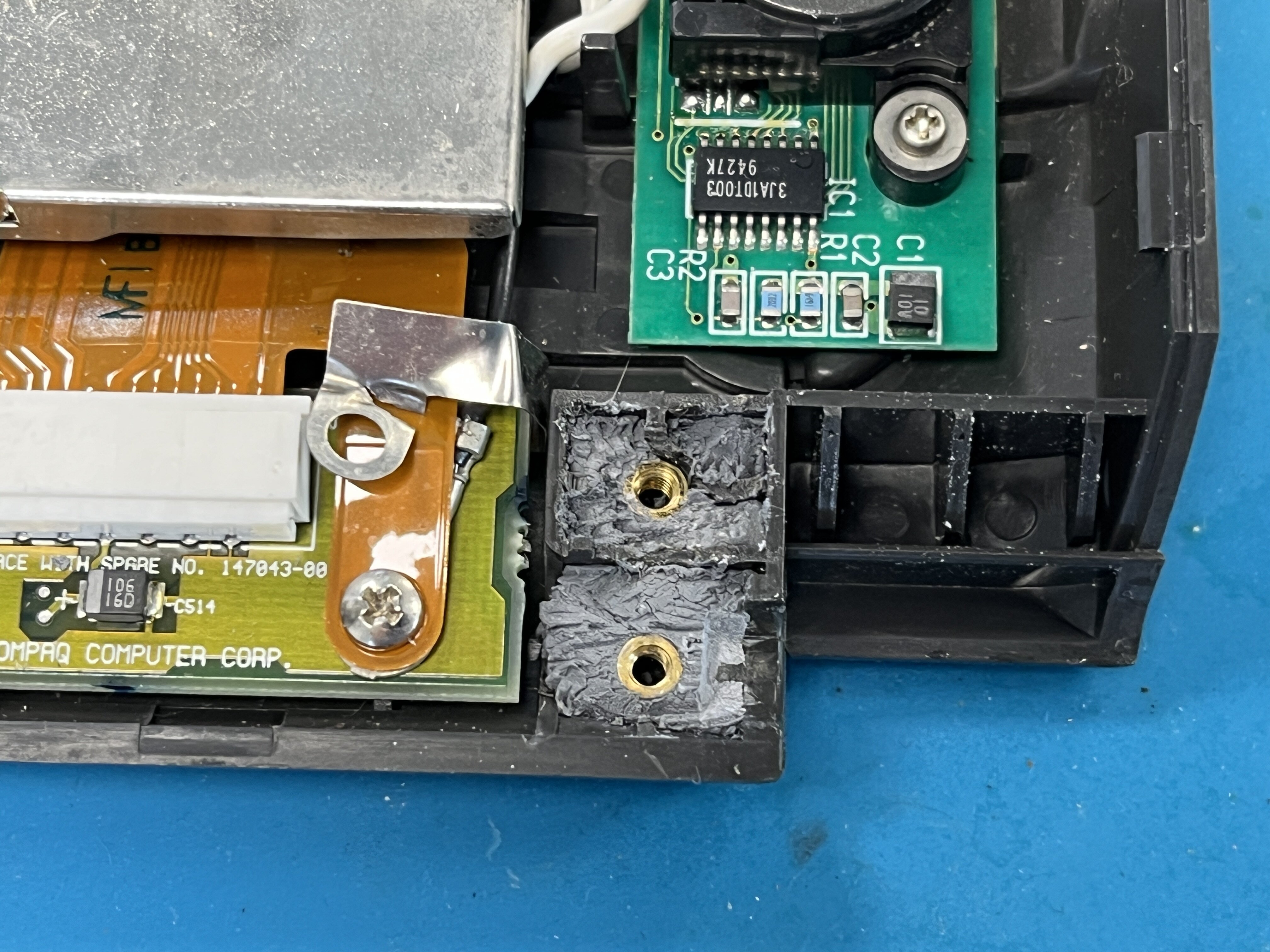

This time it's on a 32 year old Compaq Contura 4/25 I'm fixing during my lunch breaks (so it will be a while before it's completely repaired)!
Before I got the Epoxy Putty out I had to melt/heat back in to place the things the screws screw in to (as you can see from the photo above they're missing):
Now for the Epoxy Putty:
It's already set, but it's not cured yet (that takes 24hrs) and as I'm on annual leave next week it will be a while before I get to test out this repair to see just how strong this stuff is!
Full details on my personal blog: https://www.retrocomputing.co.uk/2026/03/how-to-attempt-to-repair-compaq-contura.html

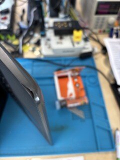

Currently using Epoxy Putty to repair a broken lid/hinge:
Just need to wait 24hrs for it to fully cure and then to give it the real test of handing it back to a Teacher!! 😮🤣😎

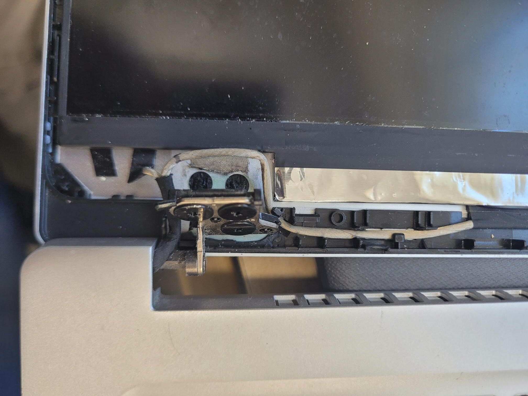

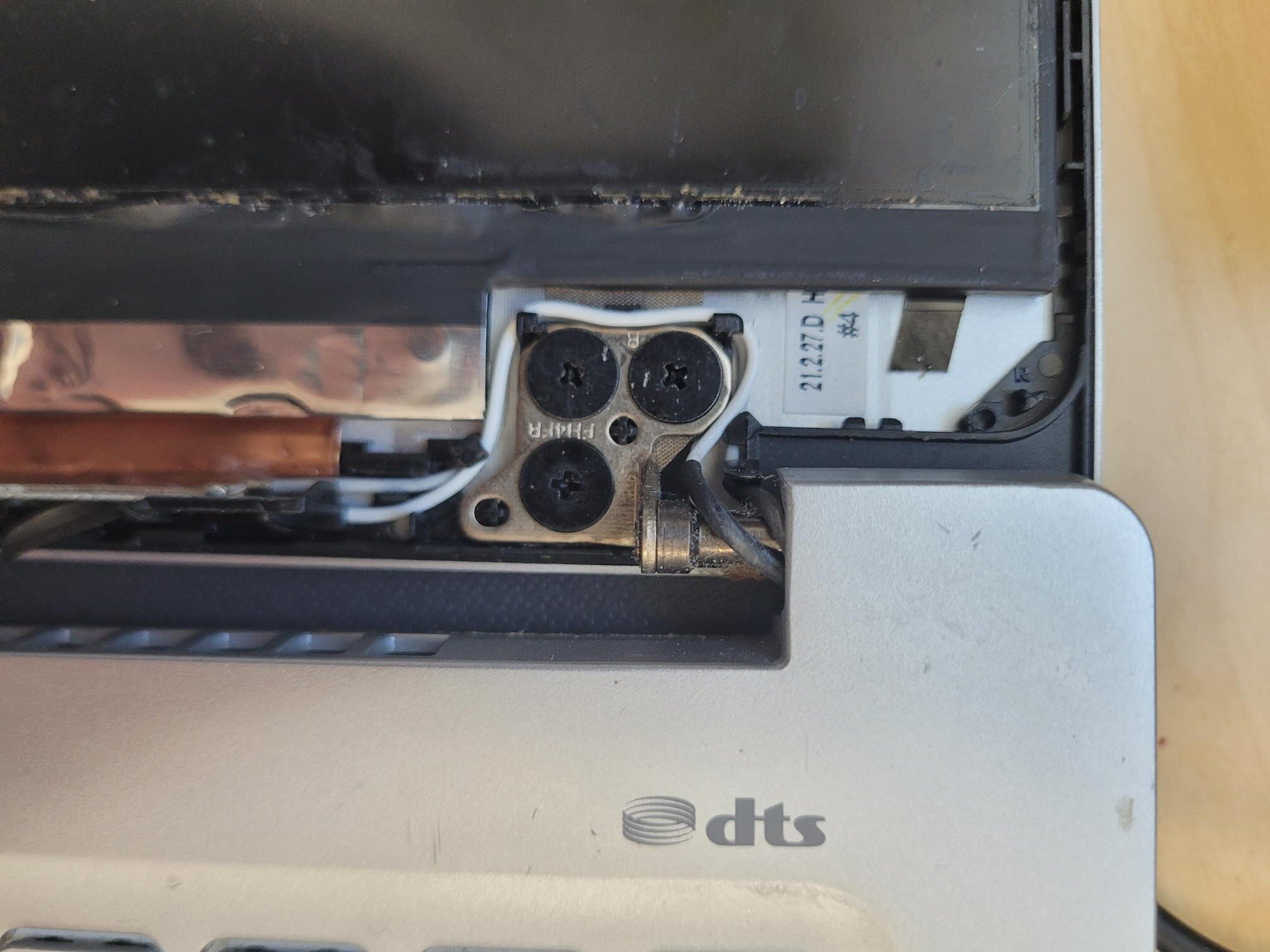

Is the hinge still repaired and working well?
I have 2 Acer Swift laptops with hinge failures which are 5 years old but still great fast laptops and have a feeling its wear and tear and ill have a lot more fail soon so going to try the epoxy on one of them soon.  Thinking about glueing the hinge back down then using a clamp overnight for it to set?
Thinking of using this

For this repair on your exact laptop epoxy is not a good idea.  I have fixed many modern thin hinges like this over the last few years and (touch wood) none have come back with the same fault.  The answer to your problem is Hot Glue.  It dries solid, but has a bit of flex on it.  Look for Sorin on YouTube (Electronics Repair School) and he will show you how to do it - you basically secure the hinge in place with hot glue, quickly fit the bezel and then use a spring clamp to hold it together whilst it sets/hardens.
I do have a few photos showing step-by-step how to do this sort of repair and it's next on my list for a repair tip but I've just not gotten around writing it on here yet!..

That epoxy is almost identical to the putty, but the putty gives more bulk and better suited for hinges IMO. I'm using that exact epoxy at the moment for broken screw holes on a laptop where I suspect the teacher used it as a cricket bat!
A few pots of mini-paints gives you an opportunity to give a little bit more of a clean finish to the fix, but it is purely cosmetic. I believe Humbrol are still around those of you that did a bit of model building back in the day.
For laptop hinges (particularly our Dell Vostros), I've been using two-part Araldite epoxy and clamping it for at-least 24 hours. Not had one come back yet for another repair, but time will tell on that!
The putty sounds a great idea for those cases with a little bit of damage, definetly going to be trying that trick out at some point!

I'm going for a hot glue stick repair, a touch of Gorilla super glue at the edges if needed, clamped for 24 hours.  Ill let you know if it works and add pics.
