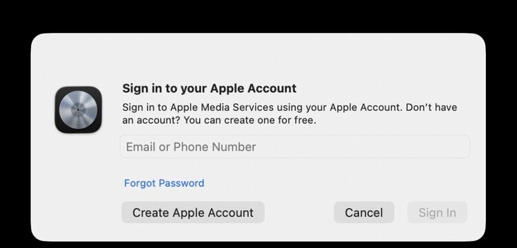

We’ve found that if you get the below message, you can move it to the very edge of the screen and use Logic normally. From testing we can open, make a project, save it, open it back up, etc.
We don't get this screen I am guessing it because I have the App store block in Mosyle, for us we just get a quit option. I am going to take a look and see if I can get this screen to appear.
Saw that too, but as soon as I did a sign on (thinking this might be the issue initially) it then just broke.

We’re then able to use Logic without signing in, the message just stays there.
We’re managed by dataJAR, so perhaps their setup / install of the app is slightly different to others?
