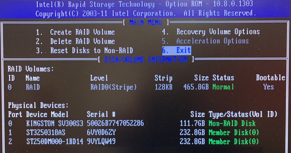

I didn't think you 'needed' to remove the single SSD from a RAID 0 array (although it's an option either way, so it doesn't matter), I thought that you were just going to create another array for the 2 other disks (IIRC you can have multiple separate RAID arrays on one card).
My old workstation has a similar configuration to what I think you are trying to do, it's not a RAID card as such so not quite so complicated/involved but the theory is the same I think.
Drive 0 (Kingston) is set up as non-RAID for the OS
Drives 1 and 2 are set up as member disks of the RAID 0 array (called RAID lol)...
Edited by Koldov
