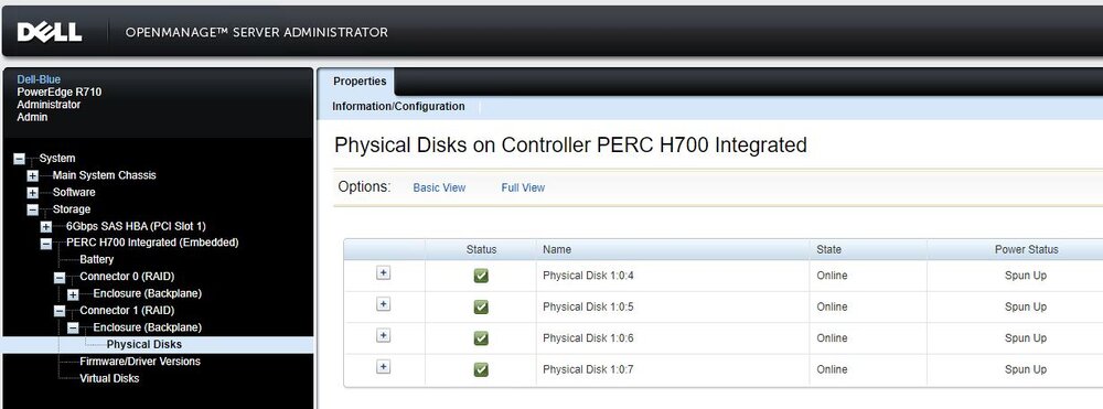

You can use Dell open manager server admin to configure raid etc
I've used it on our r710s
EDIT: You'll need to install this. Dells website and the service tag will be needed

As above, iDRAC if you've configured it for remote access, or OPENMANGE SERVER ADMINISTRATOR.
