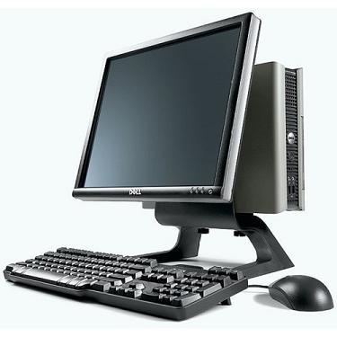

SomeITBloke Posted November 3, 2022 Posted November 3, 2022 This was some time ago but was just some that came on a roll from ESPO at the time. Used in an IT suite (Primary), these were the stands and they were all in the same place after 8 years of use. They did sit a little proud, but not that you'd notice. Nothing to loose giving it a try and less destructive than screws. 1
