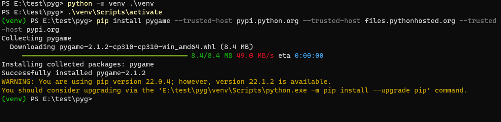

iirc you have to tell smoothwall not to inspect the domains as it breaks the certificate chain.
you can also use the command parameters --trusted-host pypi.python.org --trusted-host files.pythonhosted.org --trusted-host pypy.org to ignore the certificate errors.

you need to set the smoothwall to not ssl inspect the traffic to the domains pip is trying to hit.
Do you put those commands in the pygame cmd script?
they're for use with pip. aka this is through our smoothwall
