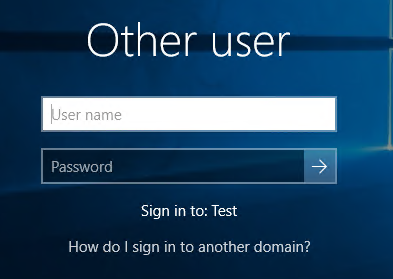

It's possible to change the display name for a domain (on the logon screen), instead of changing the FQDN, so for example -
Computer Config > Policies > Admin Templates > System > Logon - Assign a default domain for logon - Enabled
In here specify Test (for example), then restart a workstation.
The user then logs in using [email protected] - whatever their user reads in AD if you've specified custom/additional domains to your real FQDN.
If you're part of a larger Academy Trust, this can be unique per school/per GPO/per OU if you understand what I mean?
