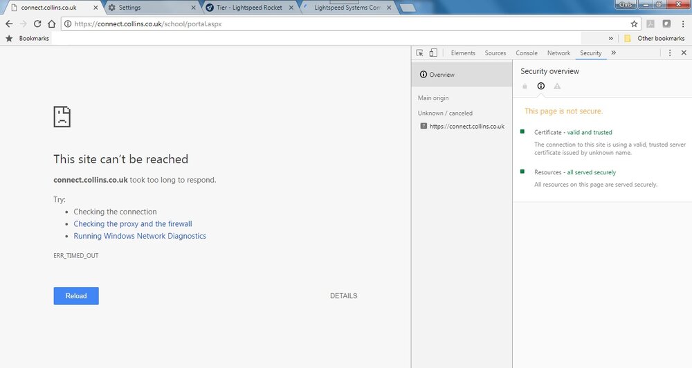

chrisakak9 Posted May 1, 2018 Posted May 1, 2018 Hi All, I have having some issues loading web pages, either receiving time out or security errors such as the this from random sites such as Collins connect. I did initially have the same sort of fault with the YPO website but seem to be able to mitigate the error i was receiving by adding the reg key as detailed here (http://forums.whirlpool.net.au/archive/2553967) The issues are mainly present on the internal networks and using IE, less so on my guest network (DHCP from router direct to filter) and using chrome, however still present to some extent. Has anybody else had these of similar issues? DC 2012R2 Workstation Win 7 64 Hosted Schools Broadband Lightspeed Web Filter Mikrotik Router

MYK-IT Posted May 11, 2018 Posted May 11, 2018 @chrisakak9 Just a thought, are you using DPI-SSL interception / filtering? If so, may need to import website certificate and/or add an exception rule.
chrisakak9 Posted May 11, 2018 Author Posted May 11, 2018 After a long drawn out process i have had this resolved. I found that the issues were not present on my guest wireless through them and trace route showed that this didn't go through an additional router that the failing networks did (tg0-0-0-0.er0.core.talk-straight.com [185.5.64.249]). but i was informed that MTU sizes were the cause (but still not going via this router now). Check your route and see if you go via this router. if you still have issues ask to speak to Sean Richards or Martin Levitt
chrisakak9 Posted May 11, 2018 Author Posted May 11, 2018 fyi if you do implement the reg fix as above some sites (ttrockstars) didn't work with this once my issue was resolved but did once the key was removed again.
